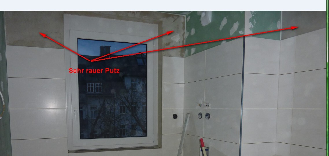

I have some areas in the bathroom with very rough plaster (applied to calcium silicate brick). Since painter’s fleece will be glued on, the surface still needs to be filled and finely sanded. However, I have concerns about using gypsum filler in a moisture-prone room.
What do you think—what kind of special filler should be used here? Something breathable. Ardex offers a wide range of products.

Sebastian792 May 2016 07:47Level it with gypsum filler – after all, it’s just a very thin layer that you apply over the cement-lime plaster.
