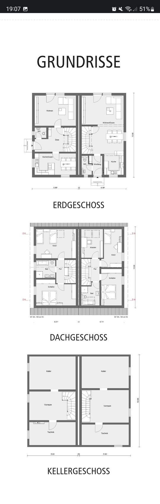

Unfortunately, I don’t have the floor plans of our house on my phone, but here are floor plans that are exactly the same as ours.
Our house corresponds to the right half of the floor plans.
I travel for work, so I can’t scan our own plans, but these are exactly the same.

The right half of the floor plans The staircase in the attic studio, although mirrored, actually belongs more to the left side. I don’t see any obvious spots for sub-distribution boxes, so it looks like all the patching will probably be done centrally in the connection room in the basement. Ceiling access points will likely be placed in the ground floor and attic corridors, roughly centered opposite the stairwell openings.

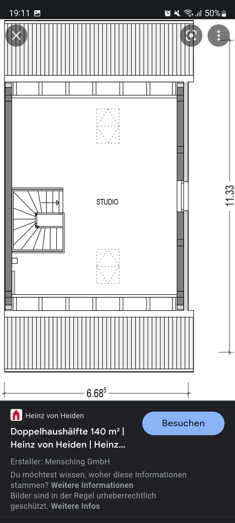

On the first floor, mounted to the ceiling in the hallway, and in the attic studio just in the middle of the room (one access point should easily cover the approximately 35m² (375 sq ft) space by itself).
Do you think one access point in the middle of the ground floor is enough, or should I install one in the kitchen and one in the living room?
In the attic, could I also use an access point with an injector and mount it on the wall? The ceiling is difficult because of the sloped roof, and there is enough LAN in the studio.
(Can I run the access point via a LAN switch using an injector, or does it have to be connected directly without a switch?)
