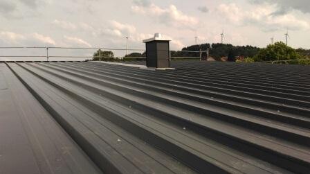

We are unsure about the roof covering.
What type of roof covering would you recommend for a 10-degree single-pitch roof?
Galvanized sheet metal or trapezoidal metal roofing, or tiled roof?
What are the advantages and disadvantages?

There are roofing guidelines for this. Normally, trapezoidal sheet metal, fiber cement corrugated sheets, or standing seam zinc roofing are suitable up to 7° (5°). Possibly with double seams or similar techniques. Depending on the requirements, the roofing may need a waterproof underlayment with sealed counter battens. Specially designed roof tiles (Braas) are reportedly capable of providing durable coverage between 12° and 7°, but whether this makes sense functionally or aesthetically is questionable. A pure waterproofing layer using roofing membranes is generally possible but should be ventilated and must either be officially approved as a "soft roofing" system for the specific site conditions (bitumen membranes), have a gravel ballast layer of at least 5cm (2 inches), or be a plastic/elastomeric membrane with building authority approval that meets fire protection requirements. The choice of material is initially determined by structural considerations, then by design, and finally by price. Roof tiles and trapezoidal sheet metal roofing are roughly similar in cost, including all additional work. Fiber cement roofing is about one-third more expensive, while zinc roofing can cost two to three times as much, depending on the roof shape.
