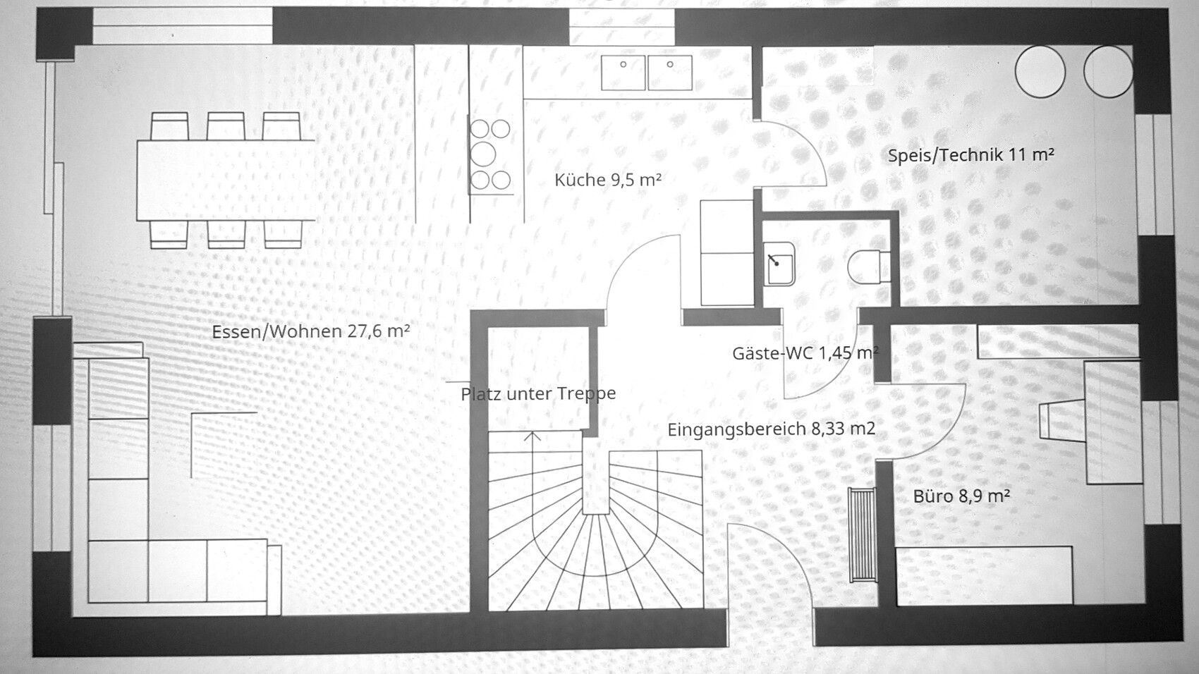

I wasn’t referring to the stair landing itself. I just wanted to describe the spot where there’s a significant bottleneck. A pinch point where everyone constantly passes through and even stops. If it were just the stair landing, it would be fine, but there is also a wall closet for hanging clothes and the MAIN access to the living area. All within 1.40 m (4.6 ft) – that causes chaos. I don’t see the problem either.
For a house of this width, I find the entrance area generous.
I see two reasonable spots for the coat rack (or even two).
Of course, more space is always better, but in my opinion, calling this a major limitation is unrealistic.
Every terraced house and most semi-detached houses have more significant space restrictions and are happily lived in by families who come and go.
The guest toilet without a window and the “walk-through kitchen” are certainly unusual, but I don’t see them as major issues.
If I count how often the window in our guest toilet is actually opened, I consider it fairly unnecessary.

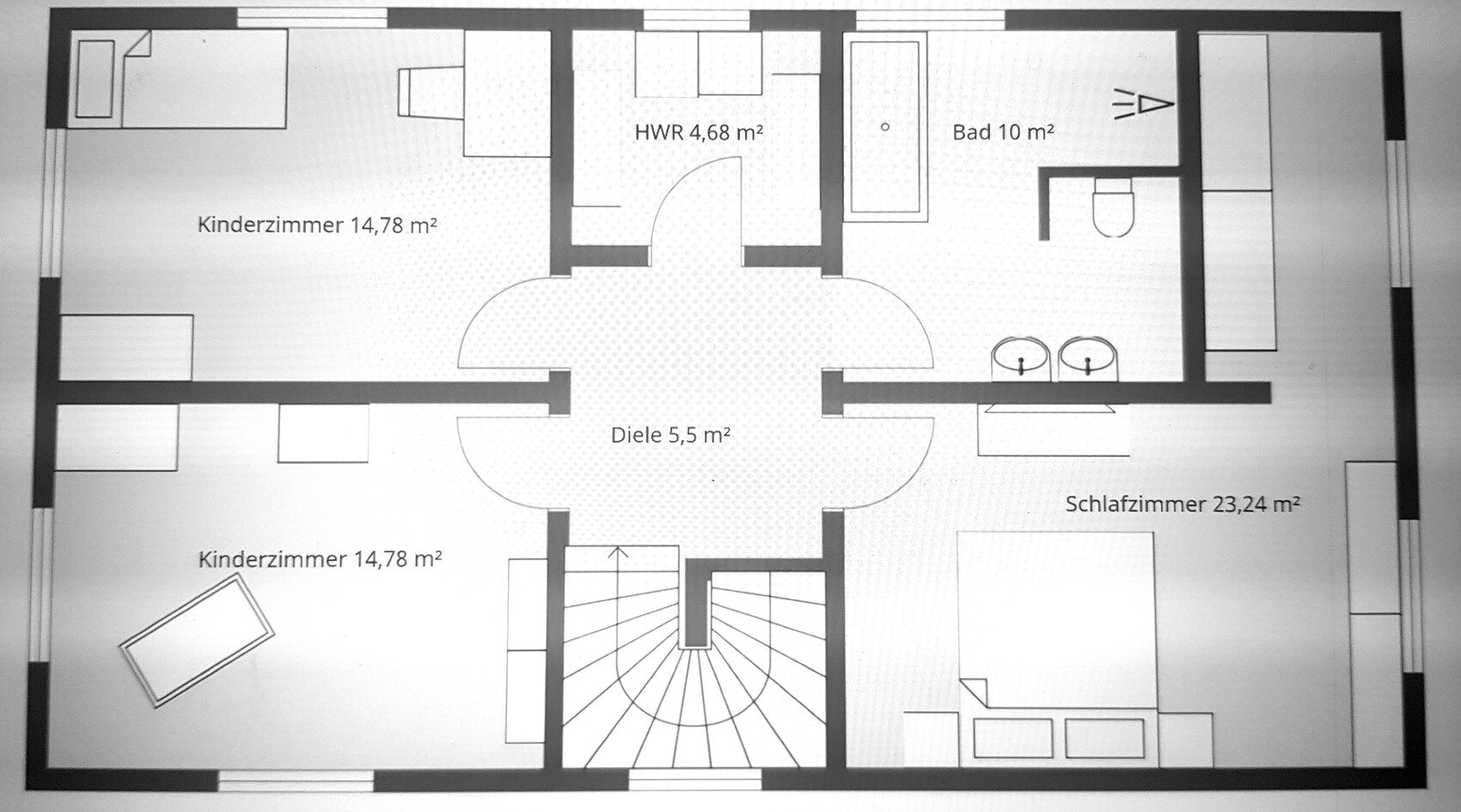

The upper floor looks good; personally, I would skip the walk-in closet entirely.
The cardinal directions are missing completely, or did I somehow overlook them?
... calling this severe restrictions is, in my opinion, unrealistic in practice.
How many townhouses have you lived in? I don’t want to live like that anymore. The narrow hallway back then was enough for me – that was enough experience. But it’s not so much about the hallway itself, rather the traffic junction in front of the staircase landing. I would reverse the direction of the staircase and do without the built-in closet. I would rather put a wardrobe in the office.
saralina8718 Nov 2019 06:40apokolok schrieb:
The upper floor looks good, I would completely skip the walk-in closet.
The cardinal directions are missing entirely, or did I overlook them somewhere?Thanks for the feedback.
I’ll try to adjust the walk-in closet later, yes.
The cardinal directions are indeed missing, sorry!
So, the children’s rooms as well as the dining area and living room would face northwest, directly toward the garden. The office and master bedroom are on the south side.
kaho674 schrieb:
I would reverse the staircase direction and skip the built-in closet. Maybe put another closet in the office instead.I’ll give that a try later, too!
