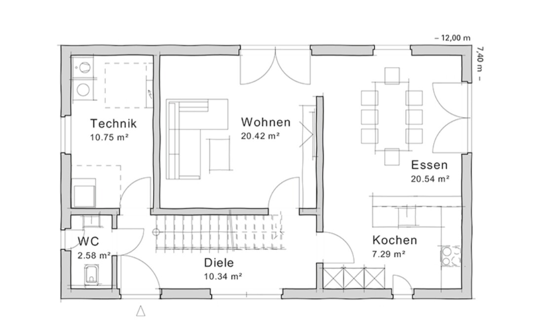

saralina8719 Oct 2019 10:08What do you think in general about the following floor plan:
I would like to add an extension (perhaps a bay window?) by the front door to create a larger cloakroom (or one at all). Also, on the other side, I’d like to have a bay window where the dining area is.
Are there any major mistakes in the layout?
It won’t be realized exactly as is anyway. 7.40 m (24 feet) is too wide.

saralina87 schrieb:
It won’t be possible to implement this exactly as is in our case anyway. 7.40m (24.3 ft) is too wide.The walls look quite thick. Let’s take 48 cm (19 inches) as an example. If you manage 31 cm (solid 17 cm (7 inches) limestone block plus 12 cm (5 inches) insulation and 2 cm (0.8 inches) plaster), the total width would be only 7.06 m (23.2 ft) with the same interior space.It’s definitely worth looking into the different wall construction methods offered by manufacturers!
As for the floor plan, my suggestions are: on the ground floor, place the restroom under the stairs (common in Canada or the UK), use the pantry for utility connections instead of the restroom, combine the heating/utility room with the living room area, and on the upper floor, put the laundry room next to the bathroom and place the technical equipment plus storage in the attic.
For example, I would place the children's rooms facing south, unless it’s a busy street. I wouldn’t put them on the north side. However, it can be very difficult to base decisions solely on the orientation.
That’s right. A difference of 40cm (16 inches) means the upper floor plan can’t be executed as is. You end up with a completely different layout... therefore, I wouldn’t rely on designs made by others but just start sketching with a pencil to see what might be possible.
saralina87 schrieb:
It won’t be possible to realize this exactly as shown for us anyway. 7.40m (24 feet) is too wide.
I don’t like the floor plan in post #80, especially the chill zone in front of the children’s rooms—it doesn’t fit the size of the house. Given the very flat plot, as estimated from the aerial view, and the possibility of two floors plus an attic, I see enough storage space (and possibly also for the utility room) upstairs, and I would categorize the basement as cost-inefficient. Regarding setback areas, it seems the neighbors have all adequately complied. On the eaves side, the eave height usually applies, as far as I know, provided there are no significant roof structures added, and on the gable side, the Bavarian height penalty should be offset by the sixteen-meter privilege. I do not see a setback story allowed here under section 34, and secondly, you would likely encounter problems with the wall heights to be counted. The house examples you and others have mentioned so far all seem suitable as conceptual bases—so from this perspective, I don’t see a reason to switch to a setback story. I wouldn’t count on bay window tricks here, but a cloakroom should certainly not be just a nice-to-have.
