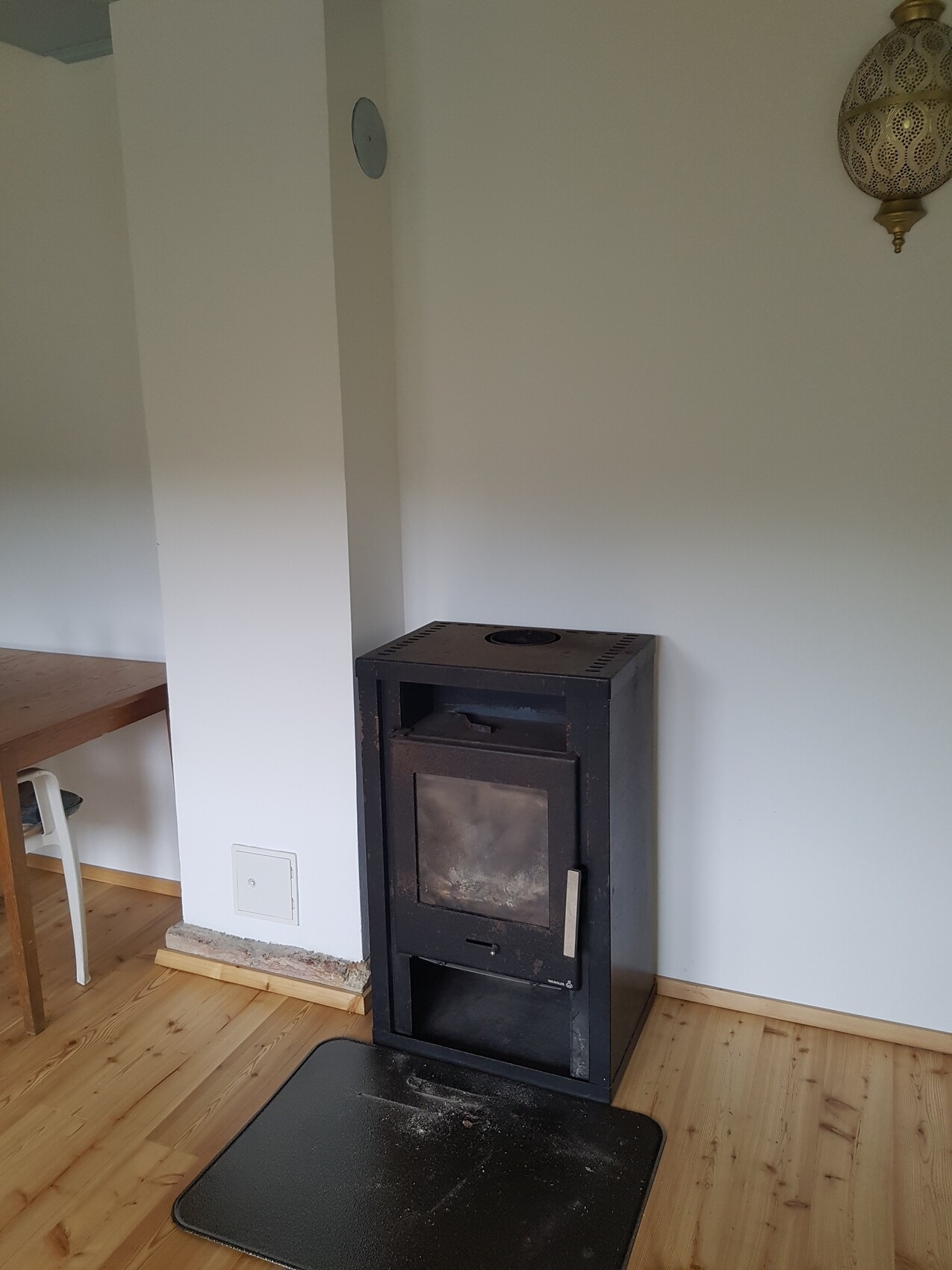

I have a stove chimney with a flue pipe connection at the top.
The chimney is located against the wall, and the chimney stack is built in front of the wall to the left of the stove.
So, I need a flue pipe going upward, then a bend to the left, leading into the (side) chimney opening.
However, the opening in the chimney stack is only 3 cm (1 inch) from the wall, while the one on the stove is 11 cm (4.5 inches).
Which flue pipe component can I use to compensate for this slight offset (difference)?
Thanks for your suggestions and help!

daniel1985ffo24 Oct 2020 15:57This one is too small. It needs to be larger towards the front and extend past the sides of the stove.
F
frankmehlhop24 Oct 2020 18:18daniel1985ffo schrieb:
But that is too small. It needs to be larger at the front and extend sideways past the stove.It is 30cm (12 inches) away from the opening on both sides and 50cm (20 inches) in front.
