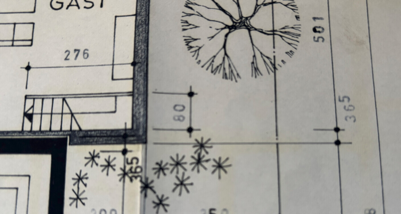

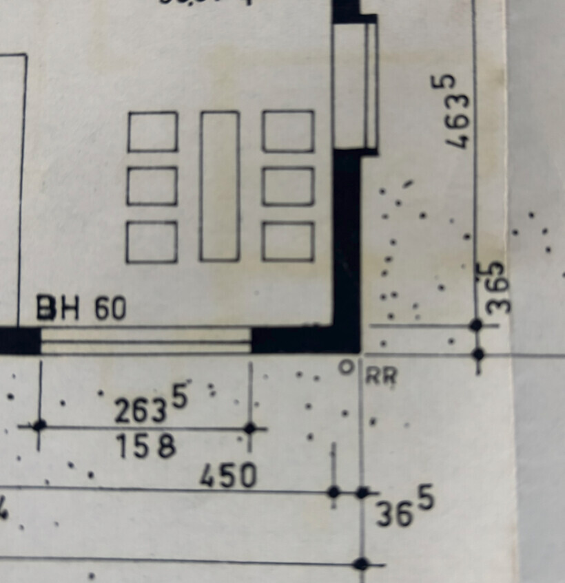

According to the construction description, this is a cavity wall 36.5cm (14 inches) thick.
Nothing further is visible in the plan:
Grundriss eines Architektenplans: Raum mit zwei rechteckigen Möbeln und Maßlinien.

User 1002 schrieb:
There is nothing else visible on the plan:
The plan shows windows whose installation position would lie within the plane of the air cavity (?)

That only helps you to a limited extent (the installation position of the windows is of course interesting) – you could check the existing windows to see how they were installed.
Here are two more examples of how buildings were commonly constructed in the past:
Floor plan of a house with dimensions and window arrangement
This is a 36.5cm (14.4 inches) wall with pumice concrete and an 11.5cm (4.5 inches) facing layer without an air gap from the mid-1960s (according to the building description, however, it is hollow brick).
Extension on the same house from 1980:
Floor plan: left building with stairs (GUEST); right garden with tree and shrub symbols and dimensions.
36.5cm (14.4 inches) from actual hollow bricks, but with 3cm (1.2 inches) insulation before the facing brick is applied. So 24cm (9.4 inches) hollow brick + 3cm (1.2 inches) insulation + 11.5cm (4.5 inches) facing brick. Don’t be surprised, this does not add up to 36.5cm (14.4 inches).
