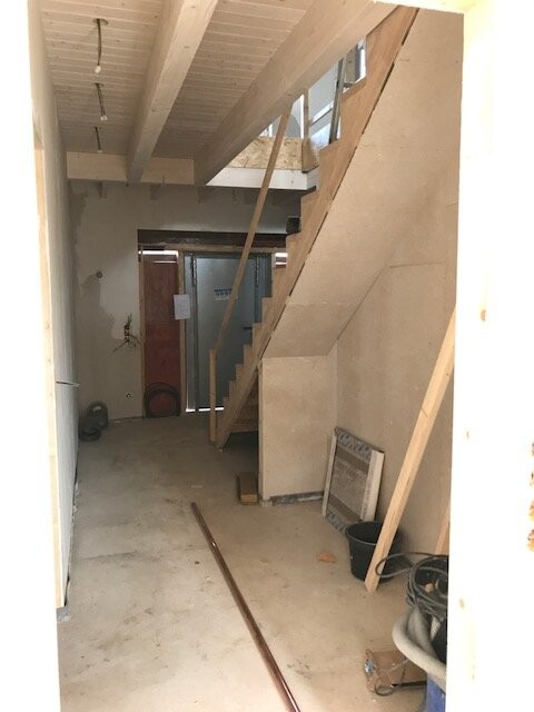

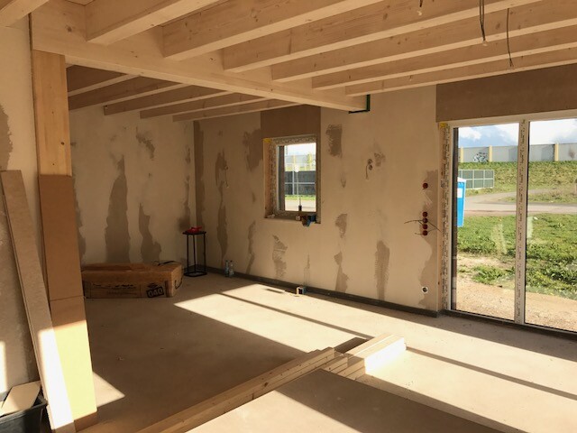

So, I need about 30 pieces. Some will be installed between the beams (as shown in the pictures), and on the first floor, they will be mounted directly into the ceiling.
I really have no idea about this and have now searched for "recessed LED downlights" on Amazon, for example. What should I pay attention to? Should they be 24V? How many watts do they need? And warm white or cool white?
