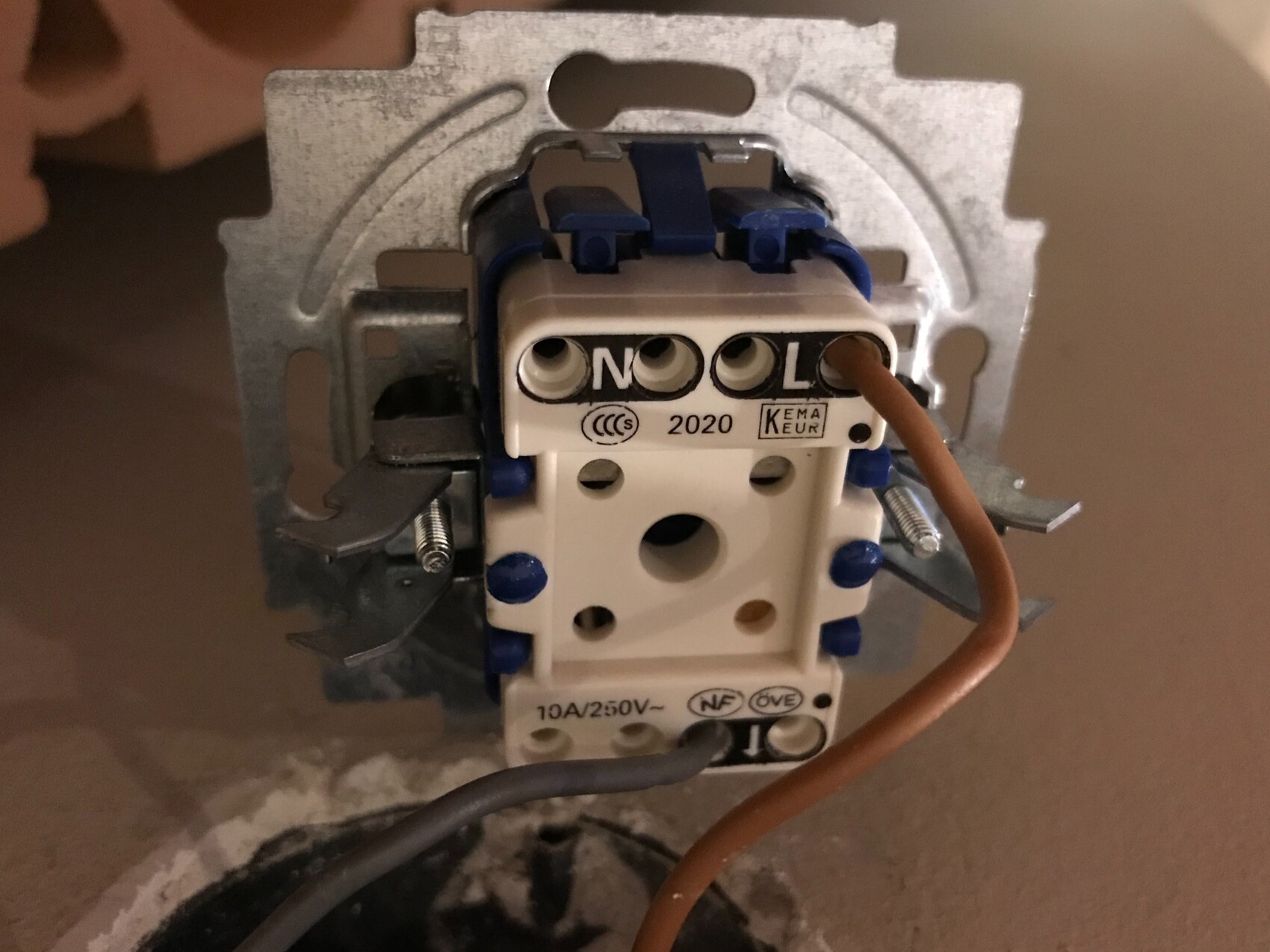

My husband is already looking forward to installing it 😉 And we’re looking forward to the photos. 😀This is the back of our dimmer 😀 There is nothing on the front.
We have a dimmer switch, not a rotary one. You’re right, photos of dimmers usually look different, but this is the dimmer switch we have, which we use to lower or raise the wattage. So what else could it be???
My husband also has an electrician contact, whom he asked after I found out that the LED bulbs I ordered are not dimmable.
“Dimmers must generally be compatible with LED.”
We were about to go out last night to buy a new dimmer, when Plan B occurred to me:
Keep the old dimmer and return the LED bulbs. They are very small anyway.
We will buy halogen bulbs instead: although they consume more power, they are dimmable, and the higher consumption will be balanced out by the savings from the new dimmer.
