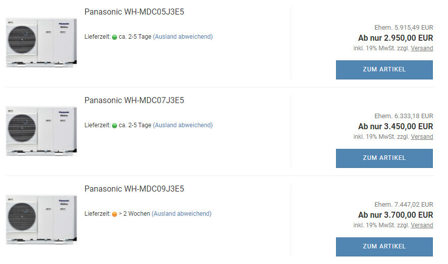

Thanks for the tip, I looked into it, but the "affordable" units are all in the low 5 kW range, which isn’t enough for my 120 m² (1,292 ft²). Why not? I manage with that, and so do many others in older buildings.

I will also take another look at the Panasonic components posted—they are heavily discounted products! But okay, I’m still waiting on shipping costs, which China-Ali doesn’t provide directly; I had to contact the manufacturers directly. (Luckily English is a global language because my Mandarin skills are somewhat limited. :cool 🙂

I’ll also check out the Panasonic parts posted – those are heavily discounted! But okay, I’m still waiting on the shipping costs, which China-Ali doesn’t provide directly, so I had to communicate directly with the manufacturers. (Luckily English is the global language, as my Mandarin skills are somewhat lacking :cool 🙂Isn’t it normal that the MSRP is just a recommendation? You’ll find that with every heating system. I would rather buy a reputable brand than “cheap Chinese junk.” With Panasonic, you just call customer service and that’s it. Nobody comes from China. But sure. You usually buy twice when you buy cheap.
