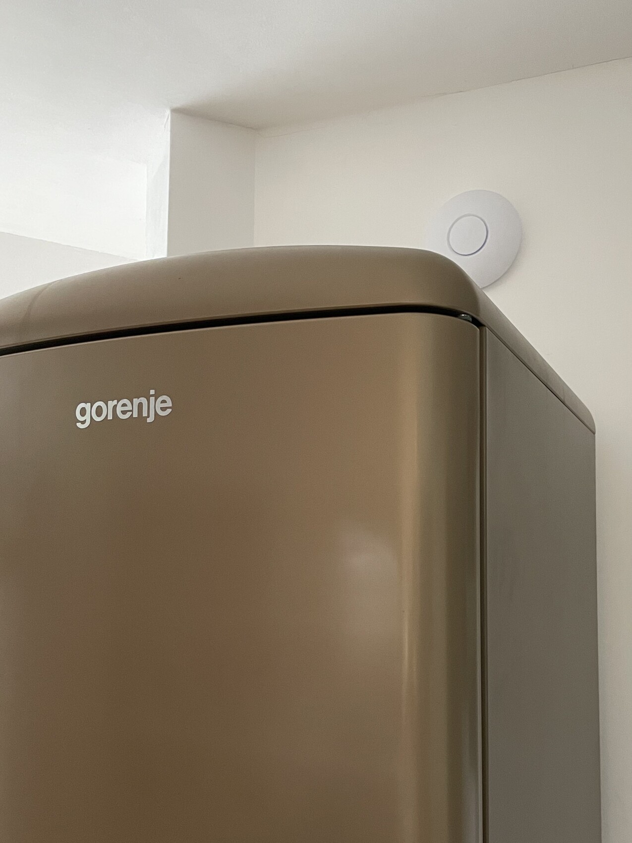

I can highly recommend UniFi; it works perfectly here, and the access points (here a Nano HD above my refrigerator) are completely unobtrusive. 🙂
Gorenje refrigerator in bronze tone next to a white wall with a round smoke detector.
rick201817 Feb 2022 12:49
Nonohd is actually meant to be installed on the ceiling. The emission angle is optimized for that.
There are also design stickers available to make it less noticeable. With a suspended ceiling, a recessed FlexHD could also be an option.
Since you usually have diffuser vents, smoke detectors, etc., on the ceiling anyway, an access point wouldn’t stand out there.

rick2018 schrieb:
Nonohd is actually meant to be mounted on the ceiling. Its radiation angle is optimized for that.
There are also decorative stickers to make it discreet. With a suspended ceiling, a recessed FlexHD could also be an option.
Since you usually have ceiling-mounted devices like diffusers and smoke detectors, an access point doesn’t stand out.
In our small 65m2 (700 sq ft) apartment, it hangs very centrally and works well, but in the house they will be installed differently 😉 Either way, I think they’re nicely unobtrusive 😀
