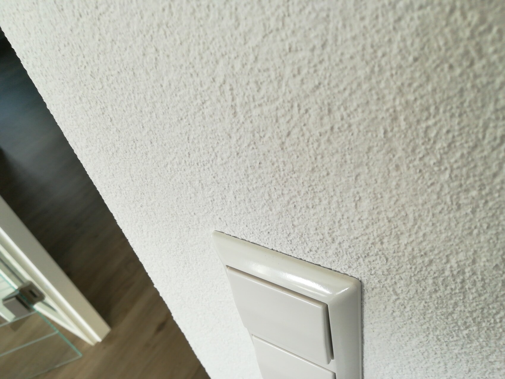

We used lime plaster throughout the entire house and are very glad we did. The air quality inside is really good, unlike in our previous apartment where drywall plaster was used.
Our plasterer also said right away: if you want drywall plaster, you’ll have to find someone else, because he won’t work with that stuff.
Our architect always builds very ecologically and pays close attention to building materials, and he would have had issues with drywall plaster as well.
Of course, it’s also a matter of cost.
By the way, we didn’t paint the walls after applying the plaster. The plaster dries to a very pleasant white shade. The surface does become a bit sandy, but we wanted to keep the beautiful texture.
We’ll see how long we stay happy with it, but so far we haven’t regretted it!

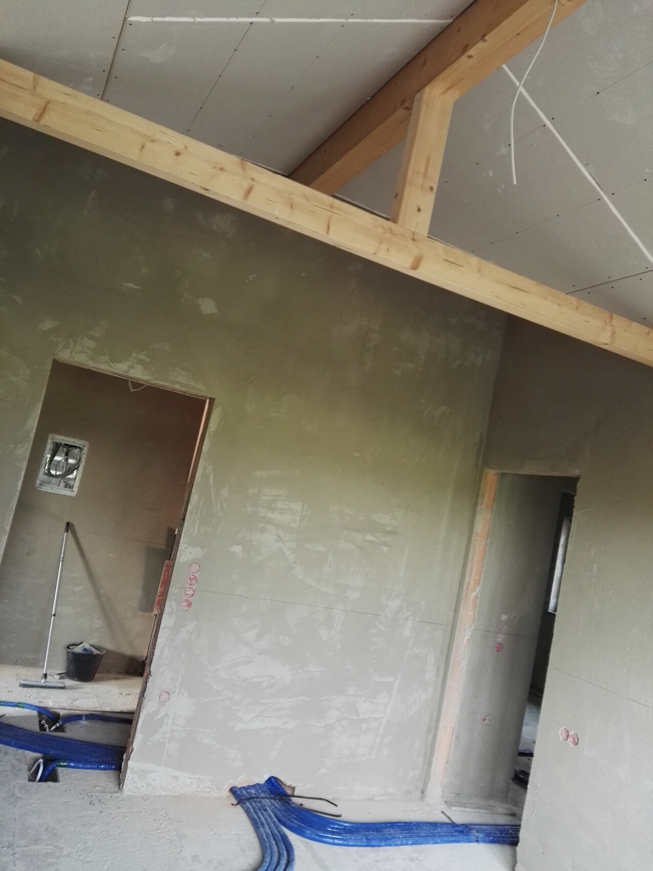

We have just had fresh lime-cement plaster applied throughout the entire house.
I’m surprised by how varied the general statements about interior plaster are. During the quotation phase, we were often told there would be an extra cost for gypsum plaster. We consciously chose lime-cement plaster instead of gypsum, accepting the associated pros and cons.
It was already dark on Friday, and yesterday I didn’t manage to have a look at all, but later today I’ll take my time to walk through in daylight and see how the final result turned out.
