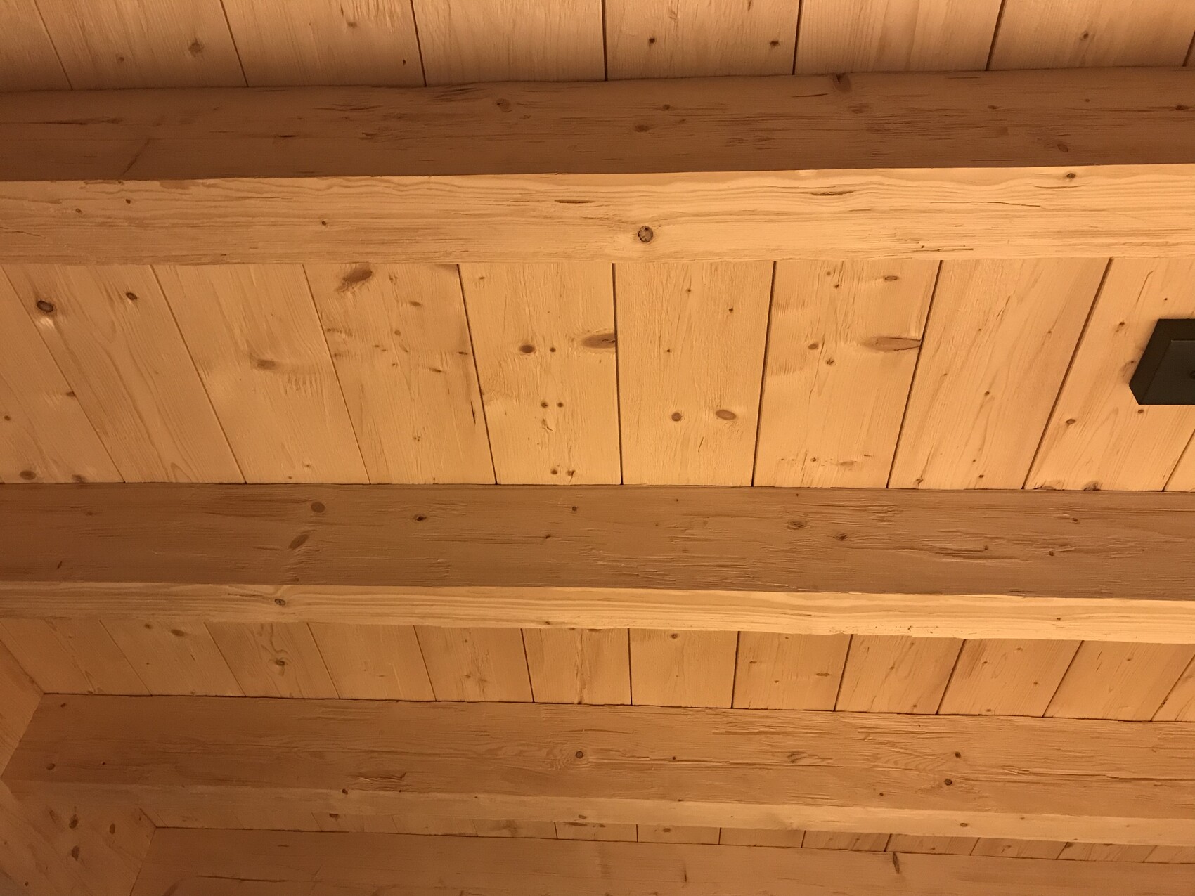

hewn wood Do you mean solid wood, processed by hand-hewing, instead of laminated beams?

Do you mean solid timber, processed like sawn wood, instead of glued laminated beams? Ultimately, it’s a somewhat more rustic look achieved by the “hewing” — whether it’s a load-bearing glued laminated beam or solid timber.

In the end, it’s a somewhat more rustic appearance achieved through the "chopping" technique – whether it’s a load-bearing glulam beam or solid timber.I can’t quite picture that.https://www.instagram.com/11antgmxde/

I can't quite visualize that.Google Image Search: "chopped wood"
hampshire12 Oct 2019 21:1211ant schrieb:
I can't quite picture that.No idea how the snapshot will turn out, I just took a photo over the dining table where there is some chopped wood. Similar topics
