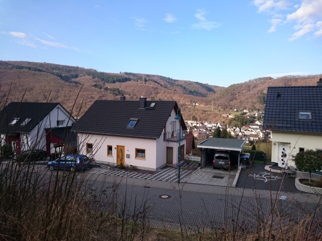

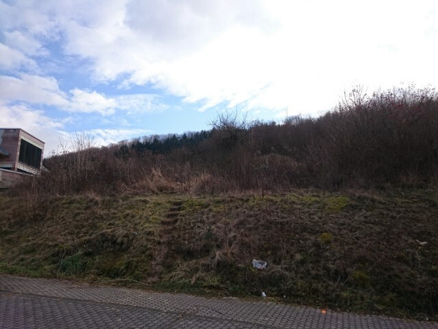

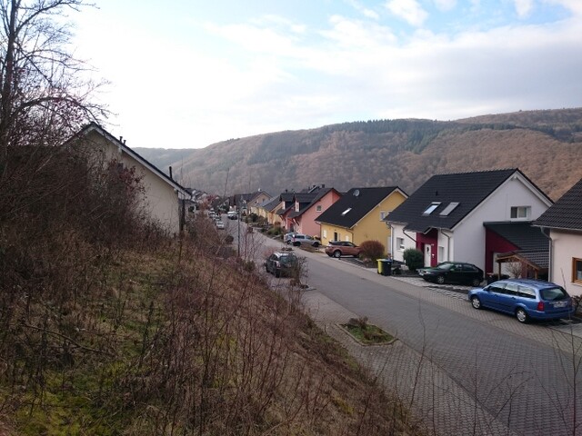

But on the south-facing roof, right?Well, not exactly. As I mentioned, it’s a river valley with steep slopes on both sides. In winter, the sun quickly disappears behind the hill. To clarify, I’m attaching a few pictures. The slope rising in the photos faces south; in the third picture, you can see the trees at the end of the hill. In the second and last pictures, you can see the other side of the river valley, where the sun still shines in places.
The roof, however, would be oriented toward the south.
