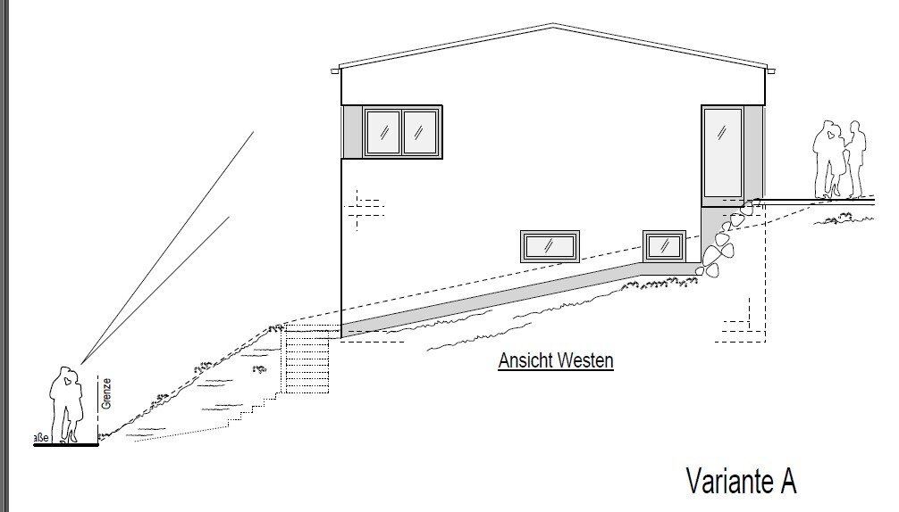

we are building a single-family house with 155m2 (1,670 sq ft) and want to try to meet KfW55 standards (at least that is what is stated in the contract). Underfloor heating is mandatory. We are working with an architect who also acts as the general contractor, so the house will be delivered turnkey.
The challenges are as follows:
1. North-facing slope – no opportunity for solar panels
2. Sloped site – the ground floor (GF) will be partially built into the hillside at the back. The bedrooms will be on the GF, while the living area is on the upper floor (UF) with a level exit “onto” the slope. By embedding the GF on one side, we can have a reasonably flat garden at the top.
3. There are currently just two of us, but a child is planned in about five years
4. We want a large bathtub and will therefore need a lot of hot water
5. I like to ventilate frequently and thoroughly
6. The utility room is on the GF along with the bedrooms. Could there be noise issues?
Now about the heating decision.
Originally, especially my partner wanted a ground source heat pump. That is probably the best option in terms of quality and ecology, but it is very expensive.
An air source heat pump is of course an alternative, but I’m concerned about electricity costs in winter because I suspect that, especially the GF, will cool down quickly due to the hillside situation.
Our architect recommends a gas condensing boiler, saying this is standard for 80% of new builds. We actually wanted to move away from gas and oil, but electricity also involves fossil fuels – at least indirectly. Of course, this would probably rule out KfW55 compliance, but I think KfW70 would also be acceptable.
What are your thoughts?
