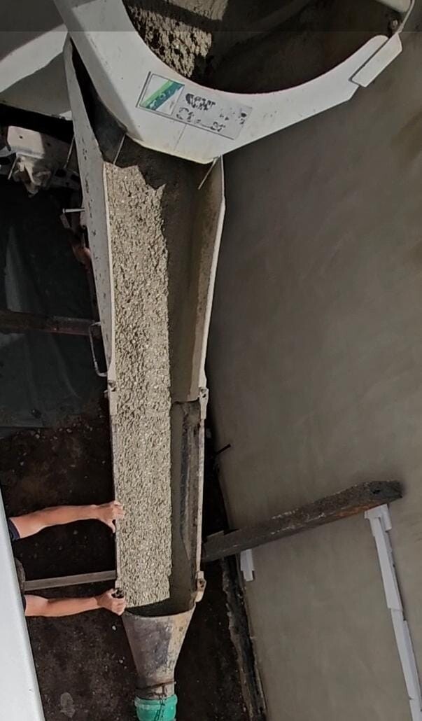

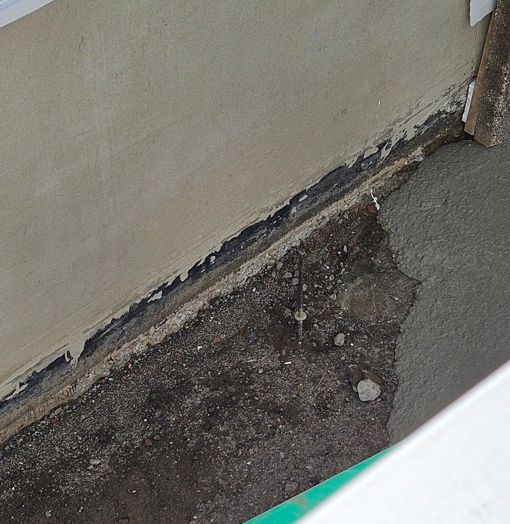

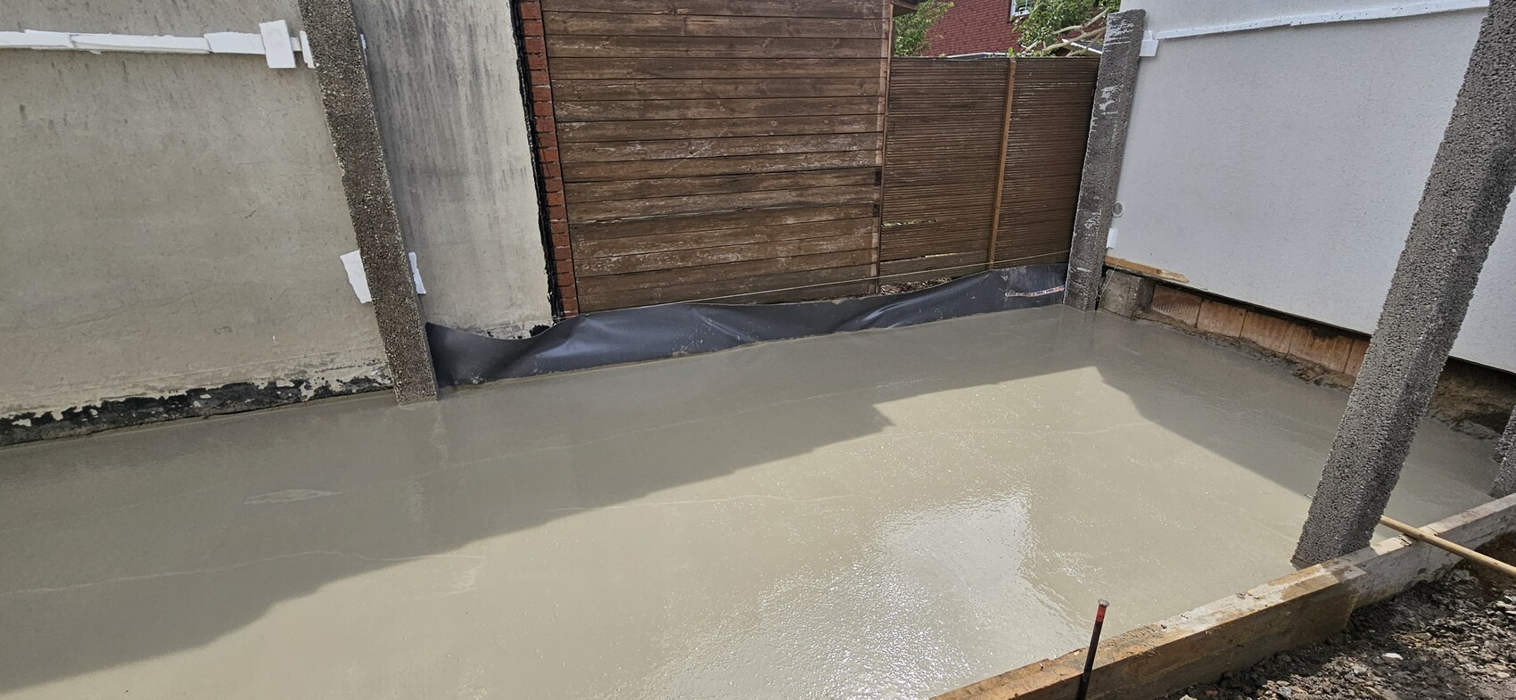

HansvonKlaus20 Jun 2024 13:13HansvonKlaus schrieb:
Is this correct, or was the wrong aspect cut back here?What does the structural engineering report for the garage say?H
HansvonKlaus21 Jun 2024 03:38The offer and contract specify the following:
Execution with an 18cm (7 inches) thick, doubly reinforced concrete slab (plus a 5cm (2 inches) leveling layer to integrate the door track) on a site-prepared base course (approximately 30cm (12 inches) thick capillary-breaking material). Surface flatness according to the requirements of DIN 18202, sheet 3.
The garage was delivered on Monday, and the driver had another customer to serve or deliver to. This delivery included three steel reinforcement mats. The garage is smaller than ours. However, we did not receive any steel mats.
Should I be concerned that the slab might develop cracks over time and that the garage could be compromised? The garage or shell is scheduled to be completed this morning. This means the slab had less than a day to cure, which seems questionable or possibly insufficient.
It's clear. Reinforced concrete slab foundation. I don't see anything, at least not in the photos.
