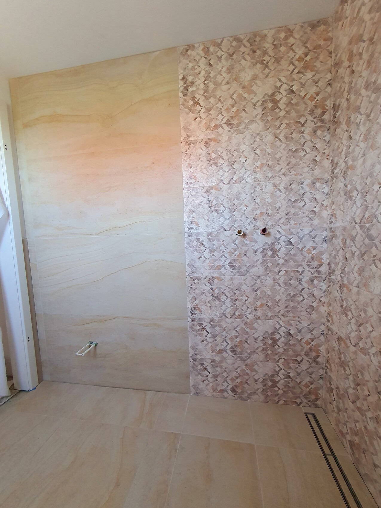

Sparfuchs7720 Sep 2020 09:33Wintersonne schrieb:
I really like that. Would it be possible to share a photo of the entrance hall tiles and the bathroom? I don’t think I’ve ever seen wall tiles that large before (only as floor tiles).Here are the bathroom tiles.
Wintersonne20 Sep 2020 10:07The floor tiles and the matching wall tiles appeal to me a lot. Honestly, the patterned tiles are not really my taste. However, I think the tiles throughout the entire house are well coordinated (especially in terms of color), which always makes a house feel complete to me.
Sparfuchs7720 Sep 2020 10:09Yes, the decorative tiles look much better in person. That’s why the glass shower wall is being installed.
Edit: Image removed due to copyright concerns.
Wintersonne20 Sep 2020 10:12I just noticed that the decorative tiles look completely different when you zoom in, so I can easily imagine that they look even better in real life, as you said.
