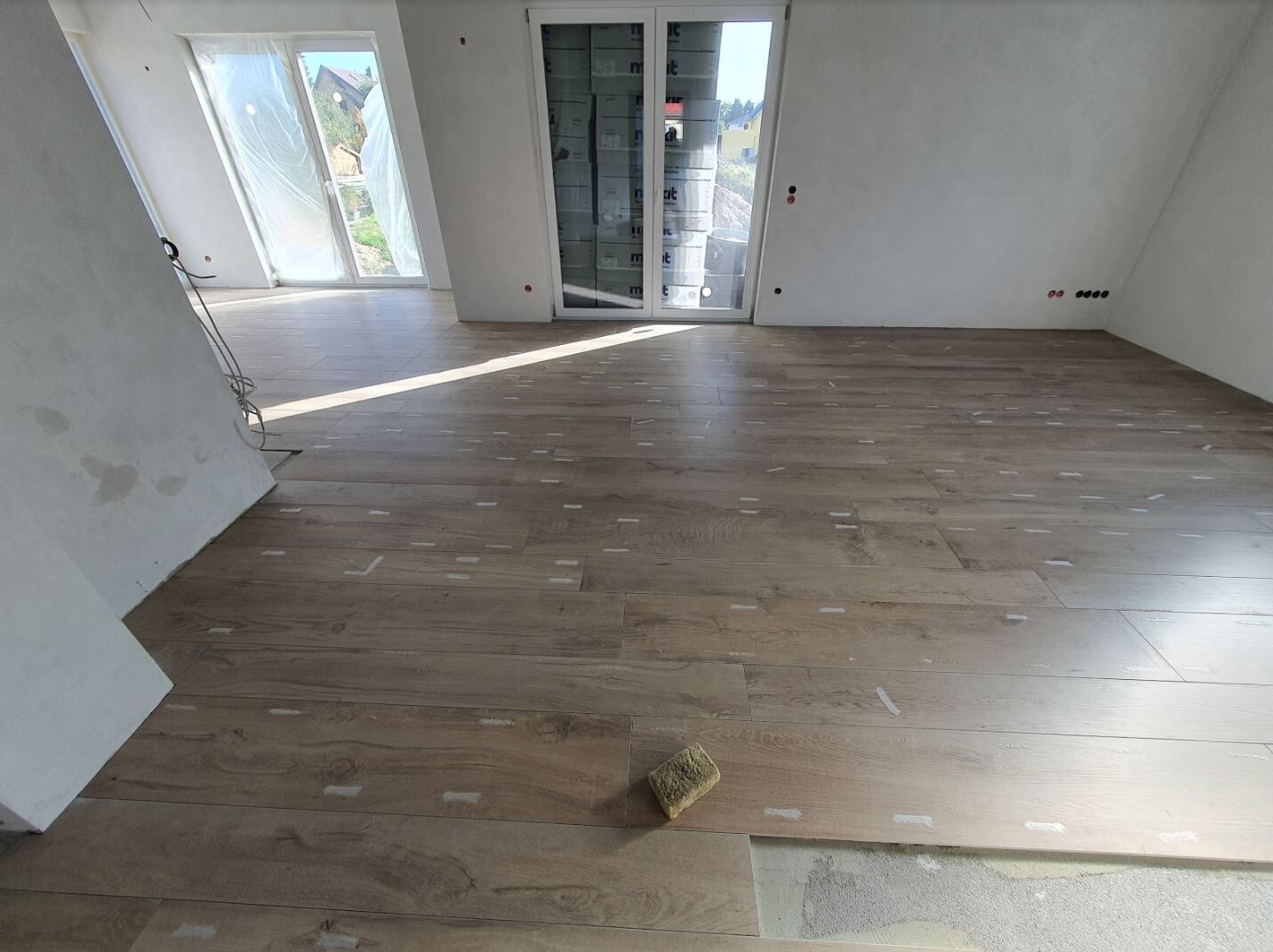

We’re probably going with nice tiles measuring 30x90cm (12x36 inches) in a country-style plank look.Keep in mind that the format is also important for the look. They don’t have to be 2 meters (6.5 feet) long. But consider whether you can get 20x80cm (8x32 inches) or 16x100cm (6x40 inches), or something similar. Narrower tiles tend to look more like planks, rather than tiles. It’s also important that the tiles are calibrated (rectified). This allows for narrower grout lines, which are less noticeable.
Our tiler installed the tiles in the living area yesterday. I’ve attached a photo to show how it looks over a larger surface. It’s not grouted yet.
For the upper floor, we chose simple laminate flooring for the first few years. Once the kids are through the roughest years, we’ll upgrade to something of higher quality.

Sparfuchs_ schrieb:
Keep in mind that the format is important for the overall look. It doesn’t have to be 2 meters (6.5 feet), but you might want to consider sizes like 20 x 80 cm (8 x 31.5 inches) or 16 x 100 cm (6.3 x 39.4 inches), something narrower. That way, it looks more like a plank rather than a tile. It’s also important that the tiles are calibrated (rectified). This allows for narrower grout lines, which are less noticeable.
Our tile installer laid the flooring in the living area yesterday. I’ve attached a photo to show how it looks over a larger area. It hasn’t been grouted yet.
[ATTACH alt="dielen.JPG"]51422[/ATTACH]
For the upper floor, we chose simple laminate for the first few years. Once the kids have grown out of the rough phase, we’ll upgrade to something higher quality. Very, very nice, this is exactly what we are imagining! Just in a slightly different color.
