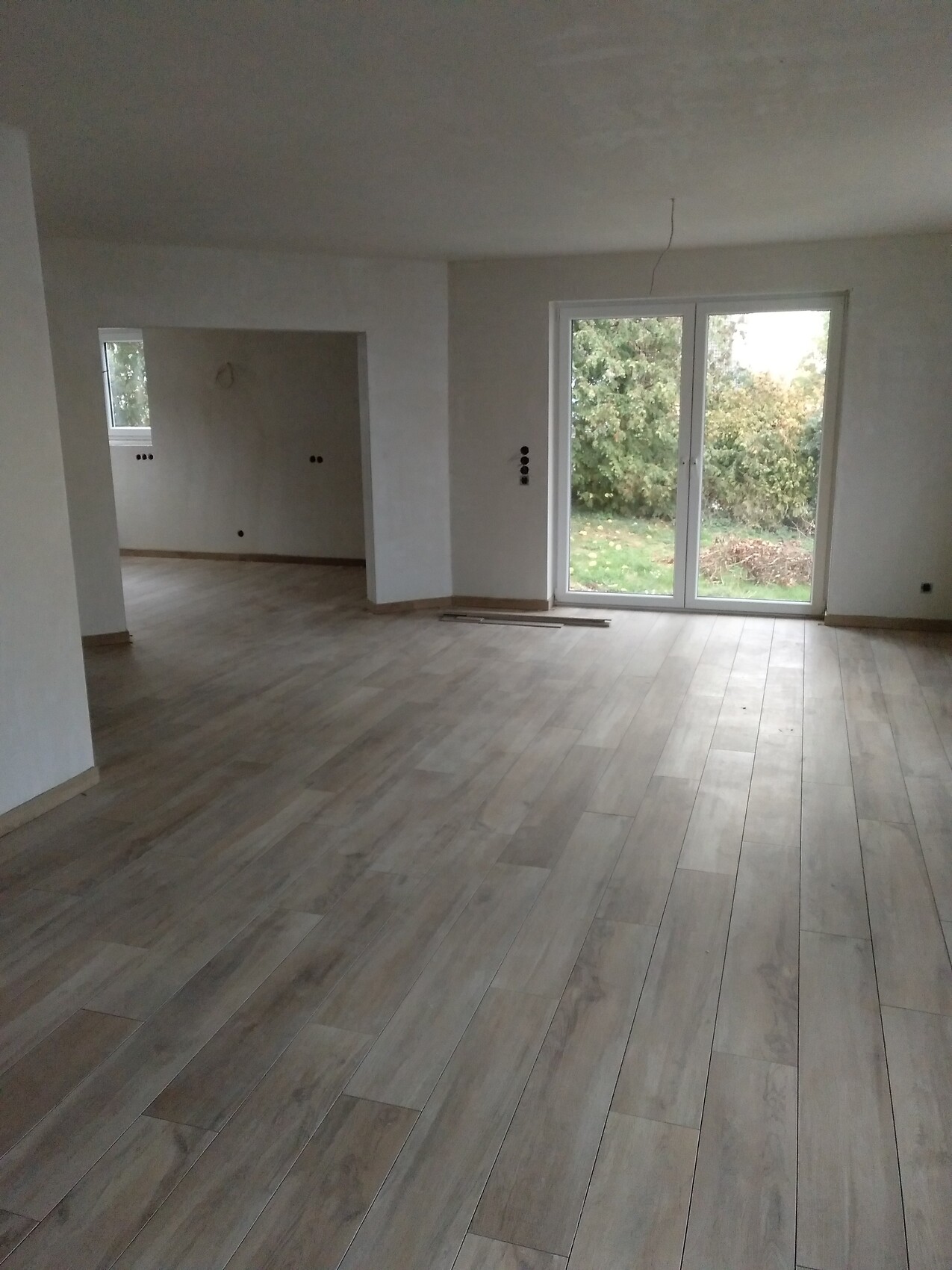

Obstlerbaum7 Nov 2018 15:29In our current rental apartment, we have tiles in the living room, which is quite uncomfortable. For the new house, we decided on parquet flooring, with tiles in the entrance area and kitchen. Also, no one is allowed to wear shoes inside anyway...
We wanted tiles in the (open) kitchen and a cozy feel in the directly adjoining living area. Also, we wanted to have just one type of flooring since it’s all open and there’s no door in between.
So we chose wood-look tiles to meet both requirements. They look great. See photo. Currently, we also have tiles in the living room, without underfloor heating. We wear socks or shoes, so it works fine. In summer, it’s also comfortable to walk barefoot.
In your case, I would do the same. Or use subtle tiles in the kitchen and hardwood flooring in the living area. I also think there should be some contrast. For example, anthracite tiles next to oak parquet.
Under the island… hmm… then the heights just have to match exactly so it doesn’t wobble or stand unevenly.
