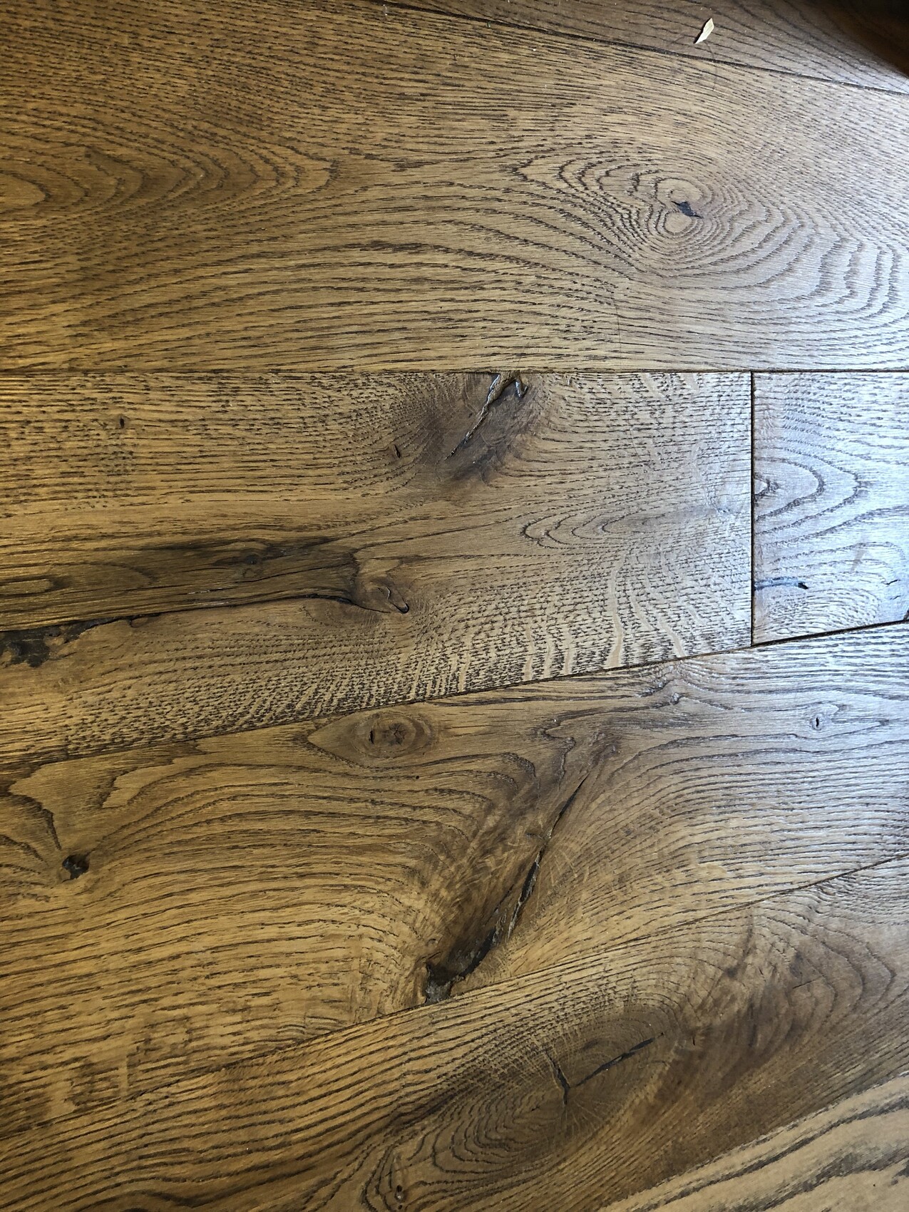

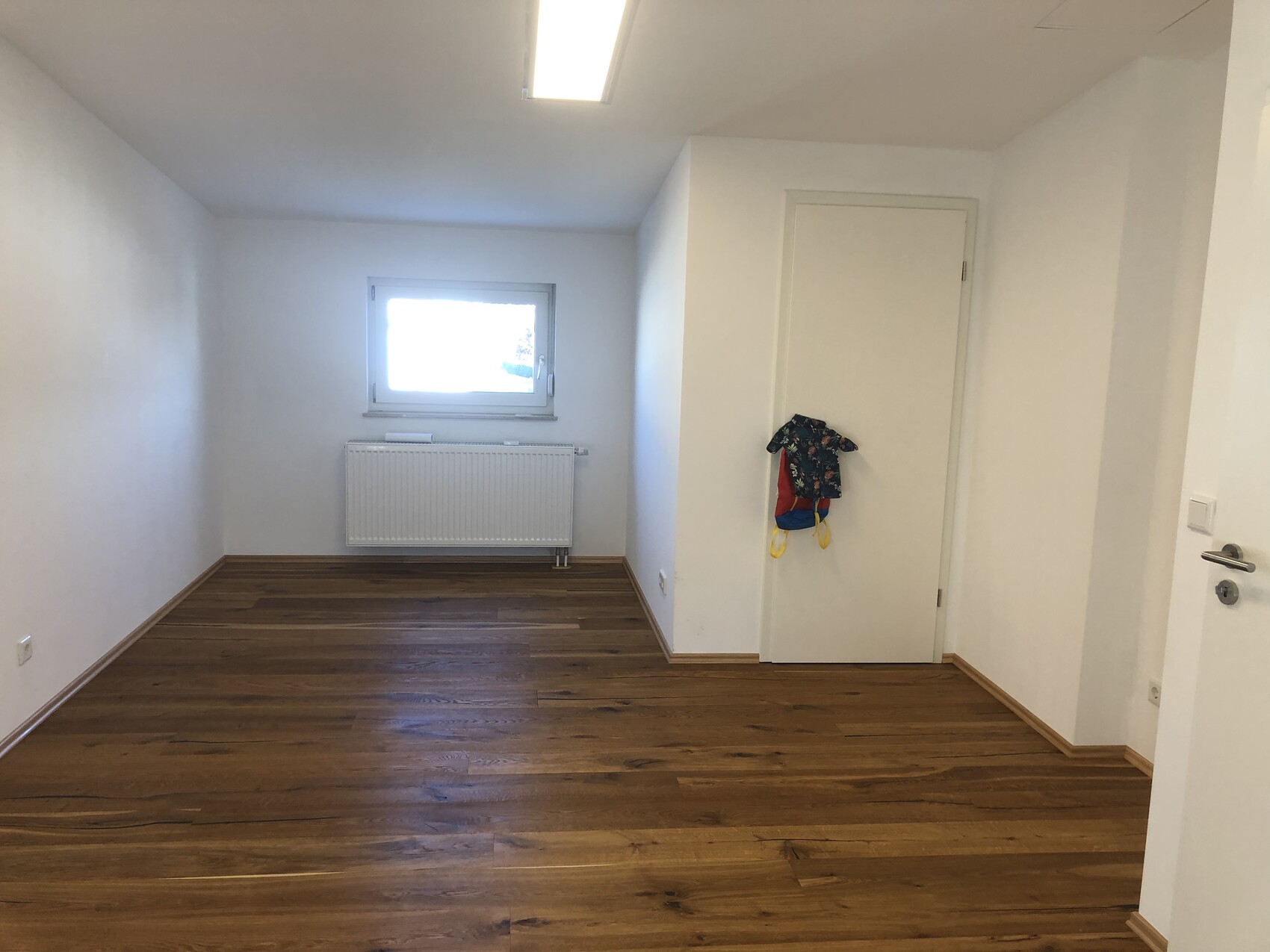

Bertram1008 Sep 2022 09:30I have oiled engineered parquet flooring over underfloor heating. Initially, it was oiled twice; now, after 2 years, I reapply oil to the frequently used rooms (kitchen, dining area, walkways). Otherwise, the maintenance effort is quite low. Keep it clean with a broom or vacuum cleaner, and if desired, you can also wipe it with a slightly damp cloth and maintenance oil.
Scratches tend to blend in quickly on wood or can be filled with ground walnut shells.
I also installed the flooring as a floating floor, so it has a bit of cushioning when walking.
