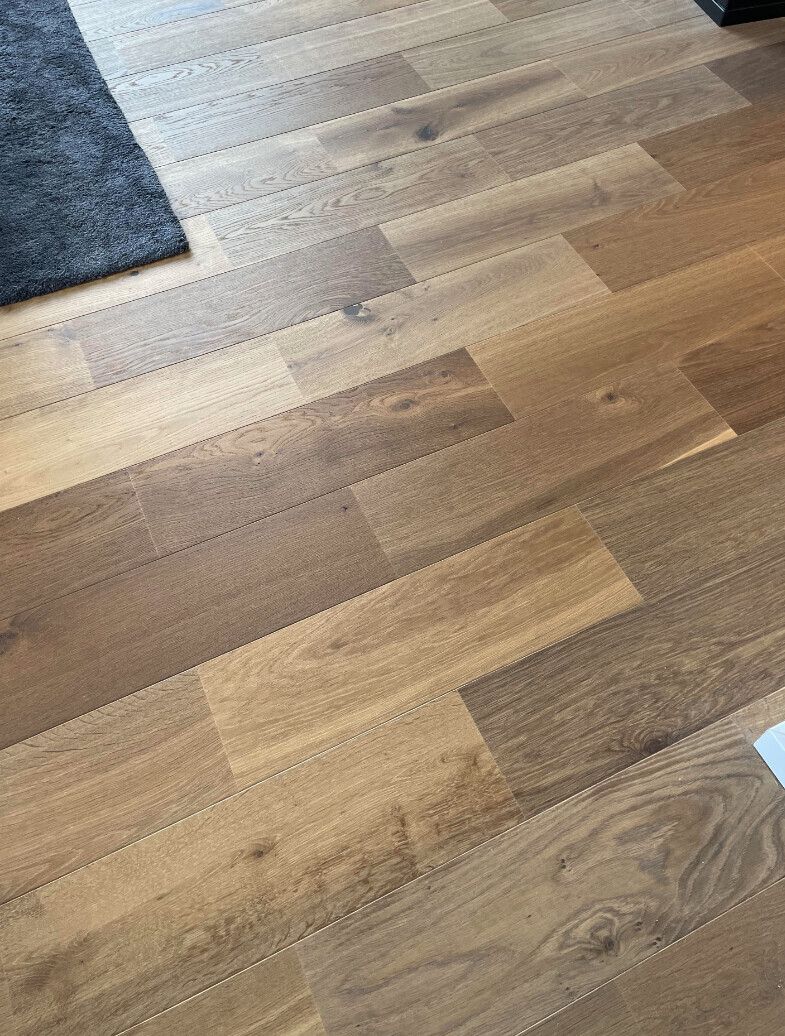

How scratch-resistant is, for example, oak parquet?
As scratch-resistant as wood can be. However, the advantage is that scratches are less visible because it is a natural material.
Haro parquet LD smoked oak, invisible structured with a long edge bevel, naturally oiled with a 3.5mm (0.14 inch) wear layer. Priced at about €30 per short plank – roughly one-third the cost of a long plank.
Wood plank flooring in brown, edge of a dark carpet in the upper left corner.
