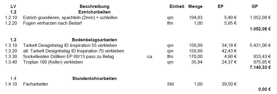

Taitv789 schrieb:
I wouldn’t dare to glue it down myself, which is why I went with a floating installation.Having it glued down doesn’t cost a fortune – not to mention it saves a lot of your own time that can be used for other things. Here are our prices from 2018: Similar topics
