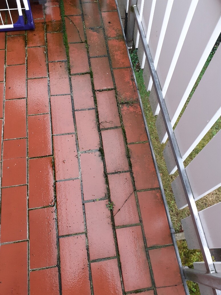

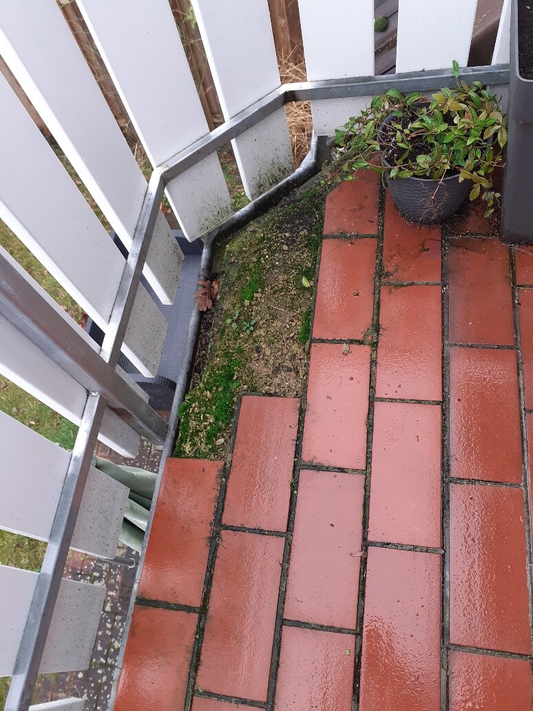

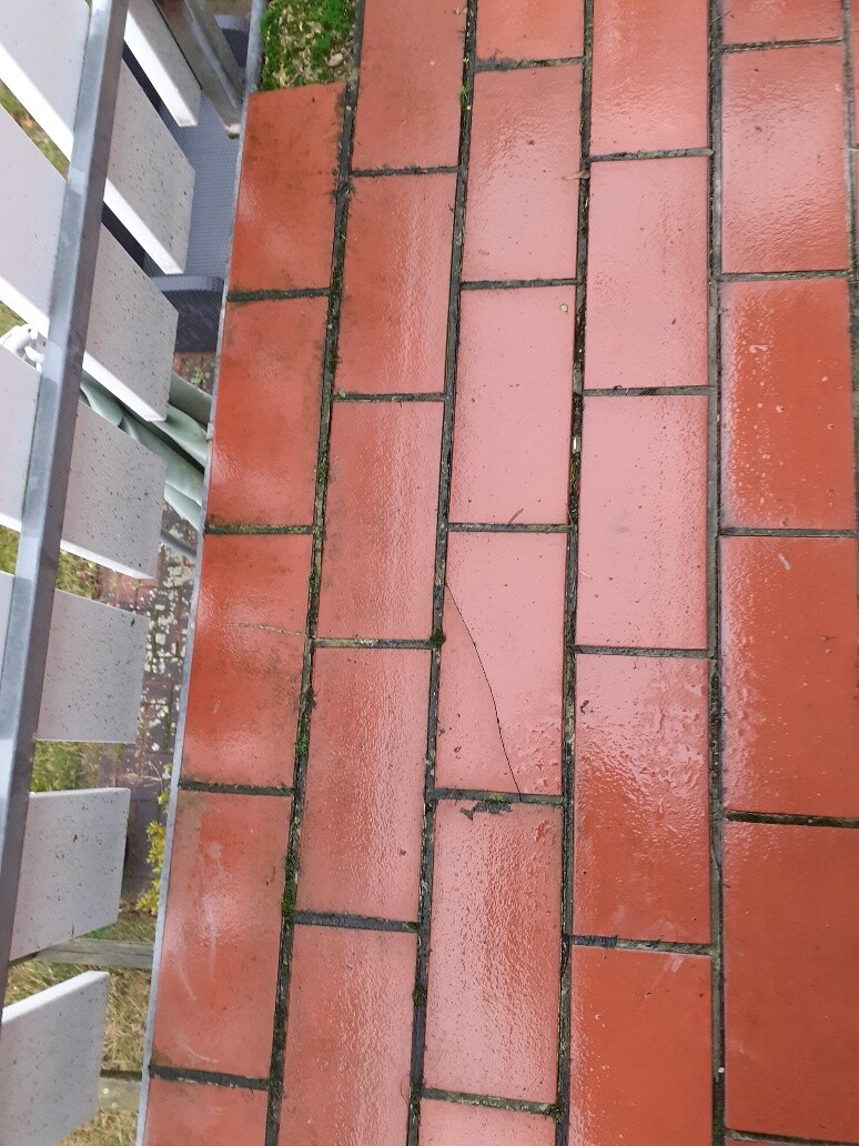

The stones on the balcony of my house, which is just over 25 years old, are chipping and cracking; see pictures. Something new is needed. What would you recommend? Are there low-maintenance synthetic coverings that can be installed here? The balcony faces west and has no roof, so it is fully exposed to the weather.

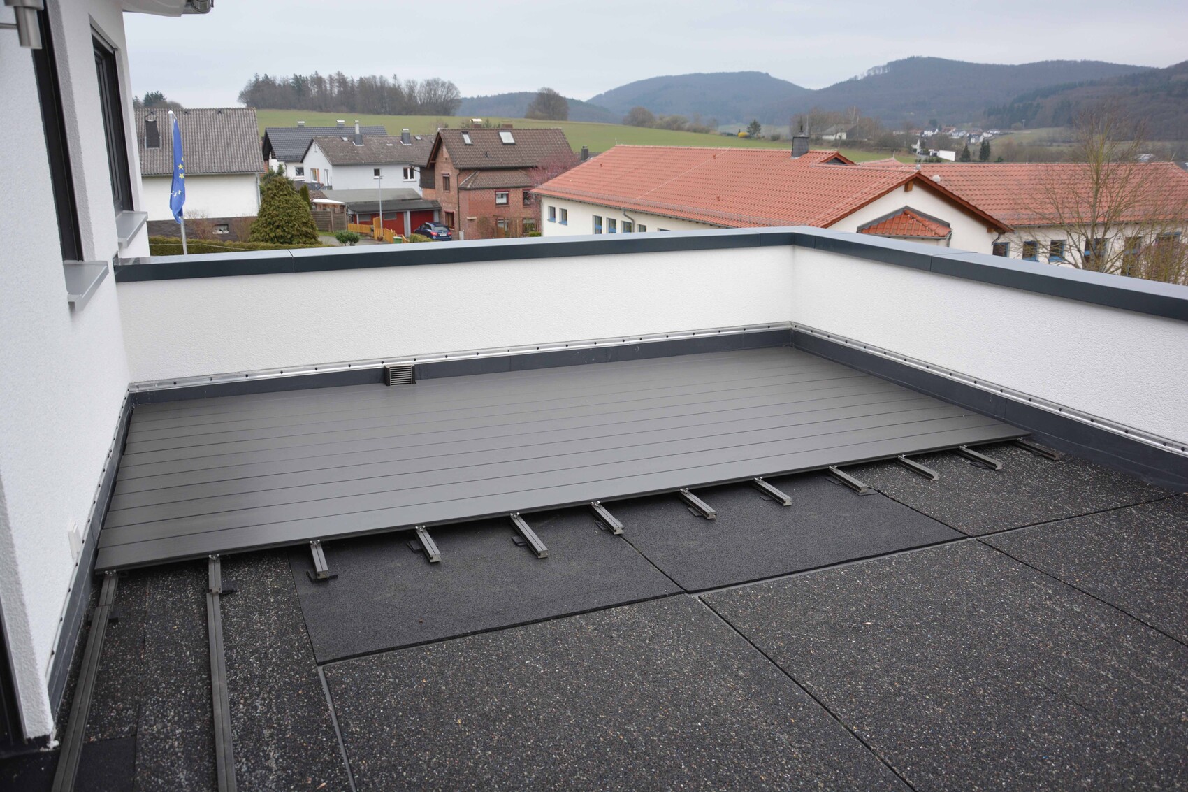

Was this installed on a garage?
No, it is on the flat roof of the living room. You can see it in the foreground of my profile picture.
Pitigliano schrieb:
How are the decking boards fixed?
There is a protective mat laid over the roofing membrane. Then comes the substructure, supported by decking pads for height adjustment, followed by the WPC decking boards. Here is another photo from the construction phase.
