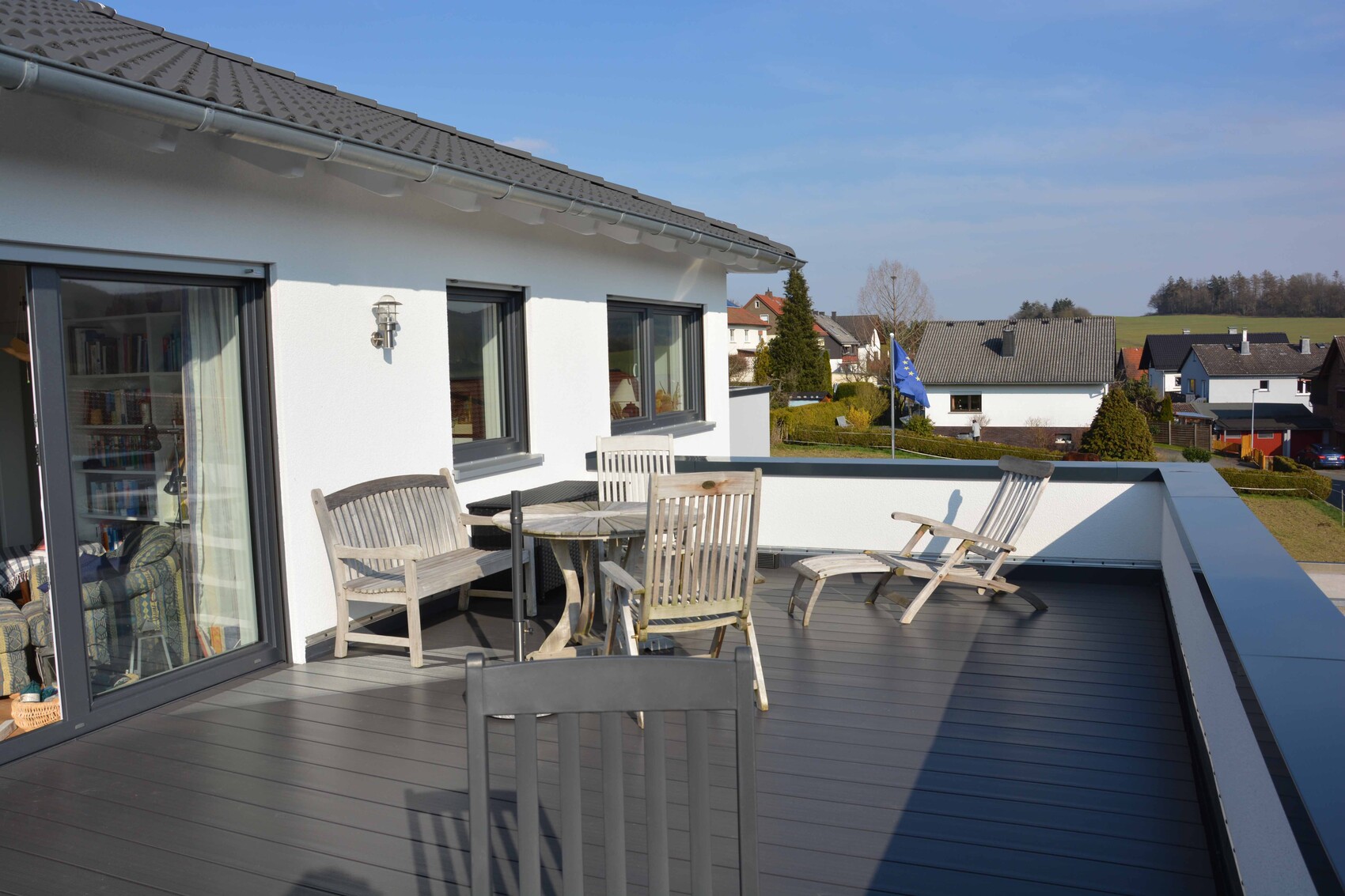

We installed WPC decking on our rooftop terrace. It worked really well.

Looks good. Was this done on top of a garage?
How are the decking boards fastened?
