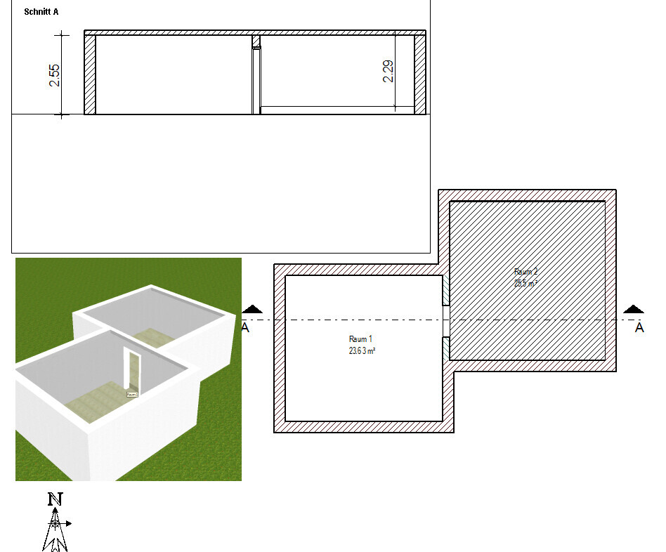

So, using reinforced concrete is probably the easiest way to achieve the goal if you design all rooms on one floor with the maximum ceiling height and create different levels by adding built-in platforms. It could look like this:
2D floor plan with room labels and 3D house view
The platform drawn in room 2 should then simply be shown as white without hatching in the illustration.
