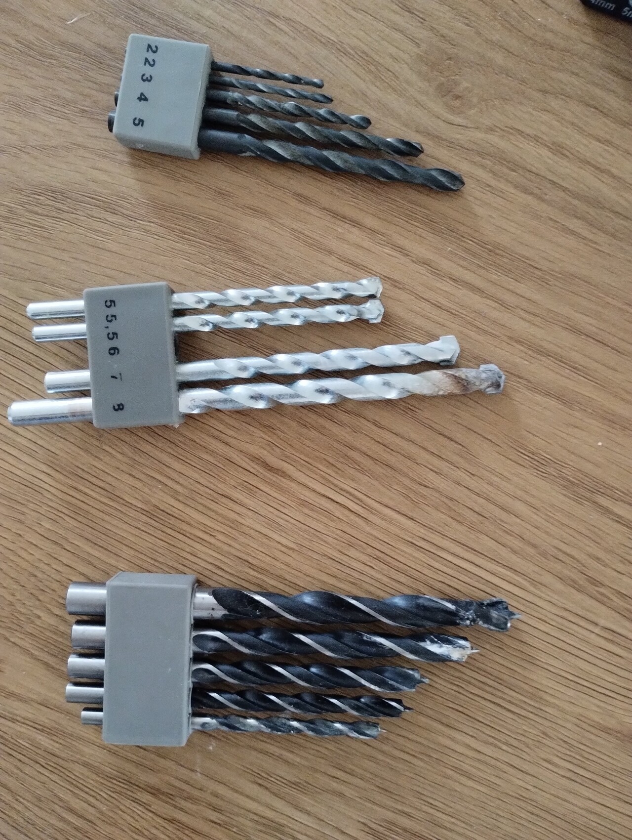

Hello forum community,
I hope this is the right place; if not, please feel free to move it.
Today, we tried drilling holes on the ground floor to hang some lamps, but we got stuck.
After drilling a short distance, we couldn’t go any further.
We tried several spots in the hallway, and only at one point were we able to drill through.
We suspect there is a steel beam, and the spot where we succeeded was where we didn’t hit the beam.
Attached is a photo of our drill bits. Our assumptions:
- The silver bit is for masonry and concrete
- The bits below are for wood
- Are the top bits suitable for metal, or do we need different ones for that?
Unfortunately, the instructions we found online aren’t very clear.
As a result, we already used the wood drill bit on the ceiling, which wasn’t good for it.
Is it even possible or recommended to drill through a steel beam, or should we try to find a spot where the masonry bit works well?
Hafenguy schrieb:
Borrowed a rotary hammer from the local hardware store around the corner, grabbed a drill bit for stone and concrete, and everything went smoothly.By the way, you’ll need this tool every time you want to hang something new from the ceiling. I can only recommend either buying one or having access to one through neighbors. Usually, we want to hang new things on Sundays anyway...Invest once in quality tools and enjoy peace of mind for life!
