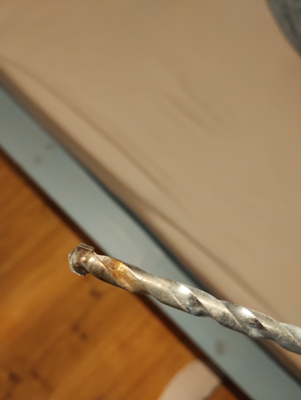

Buchsbaum0669 Sep 2024 16:10First, get yourself a decent drill bit. The drill bit set you used was probably cheap, but it’s trash.
Ideally, use a four-flute concrete drill bit from Hilti or another high-quality manufacturer. It might cost around 10-12 euros (about 11-13 USD), but it will last three times as long. Anything else is simply frustrating and won’t get you anywhere.
They all have SDS shanks, but if necessary, you can also fit them into a regular chuck of a hammer drill. Without a proper drill bit, even the best drill won’t help you.
You only need a 6mm (1/4 inch) bit, maybe 8mm (5/16 inch), for fixing a lamp.
Buchsbaum0669 Sep 2024 20:32When drilling, please use a reduced rotational speed. If you drill too fast, the drill bit will overheat and become damaged beyond use. So always drill slowly and carefully.

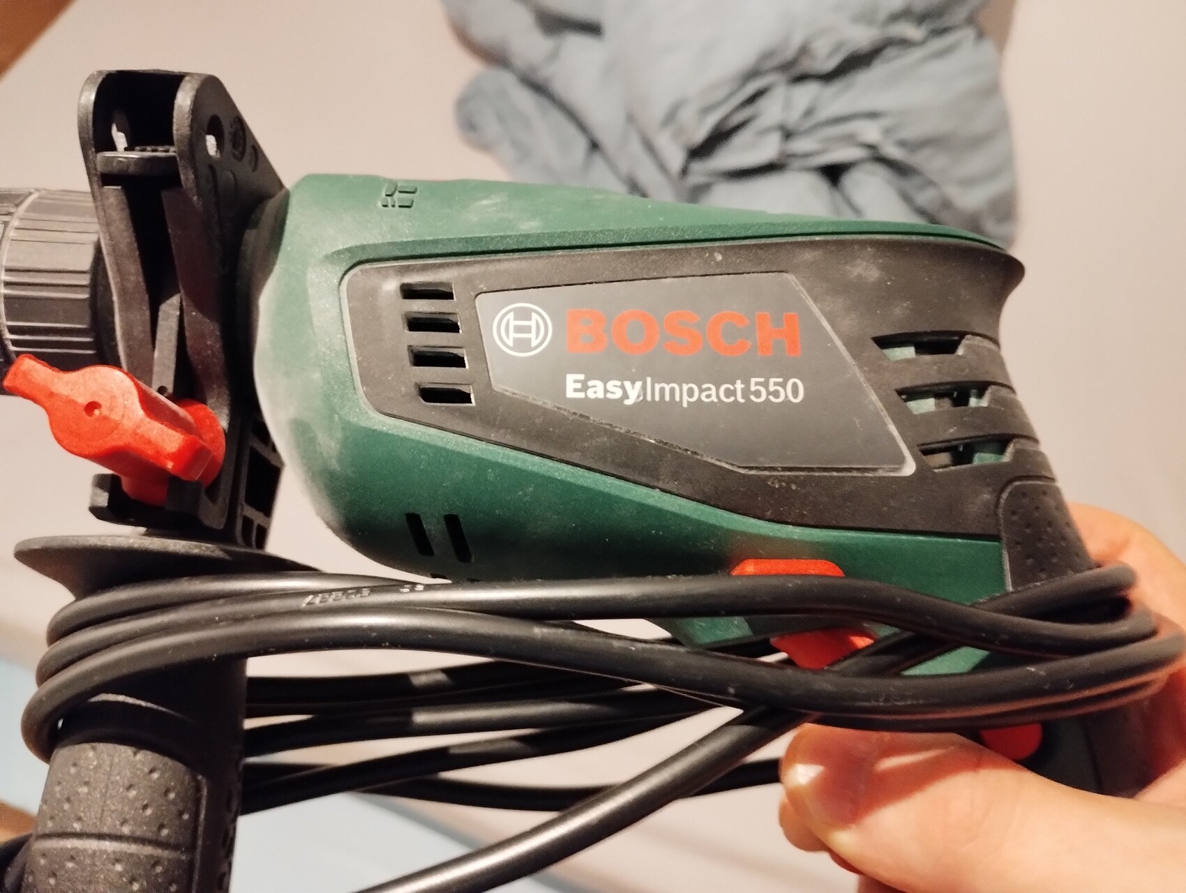

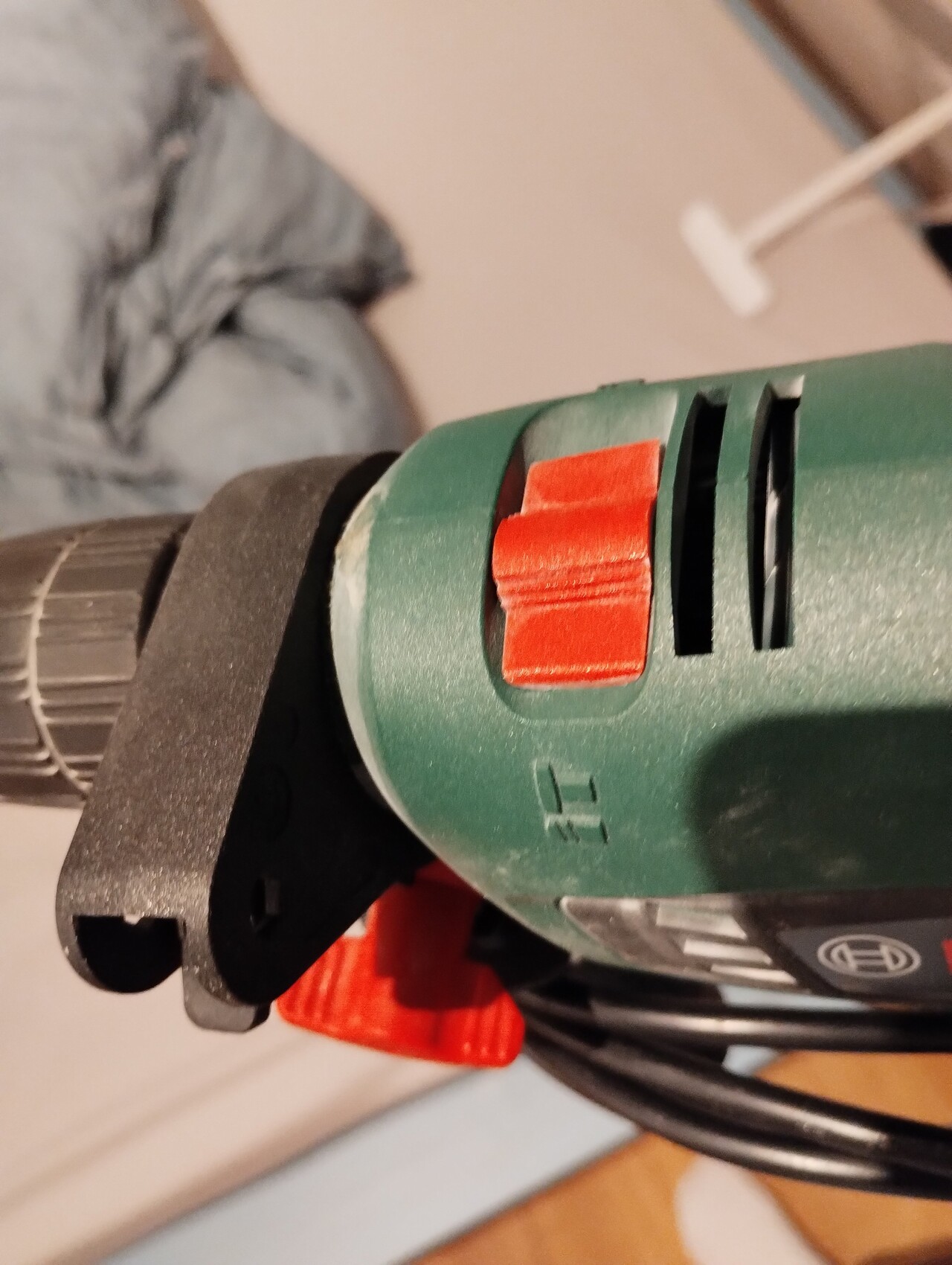

RotorMotor9 Sep 2024 20:48The drill bits are perfectly fine.
As several people have already mentioned, when drilling into concrete, the impact function is what matters.
A cordless screwdriver or something similar that only vibrates slightly is not sufficient.
What kind of machine did you use for drilling?
Oh, and of course, when drilling into reinforced concrete, you might encounter steel.
In that case, you need to carefully consider whether you really want to drill through it.
