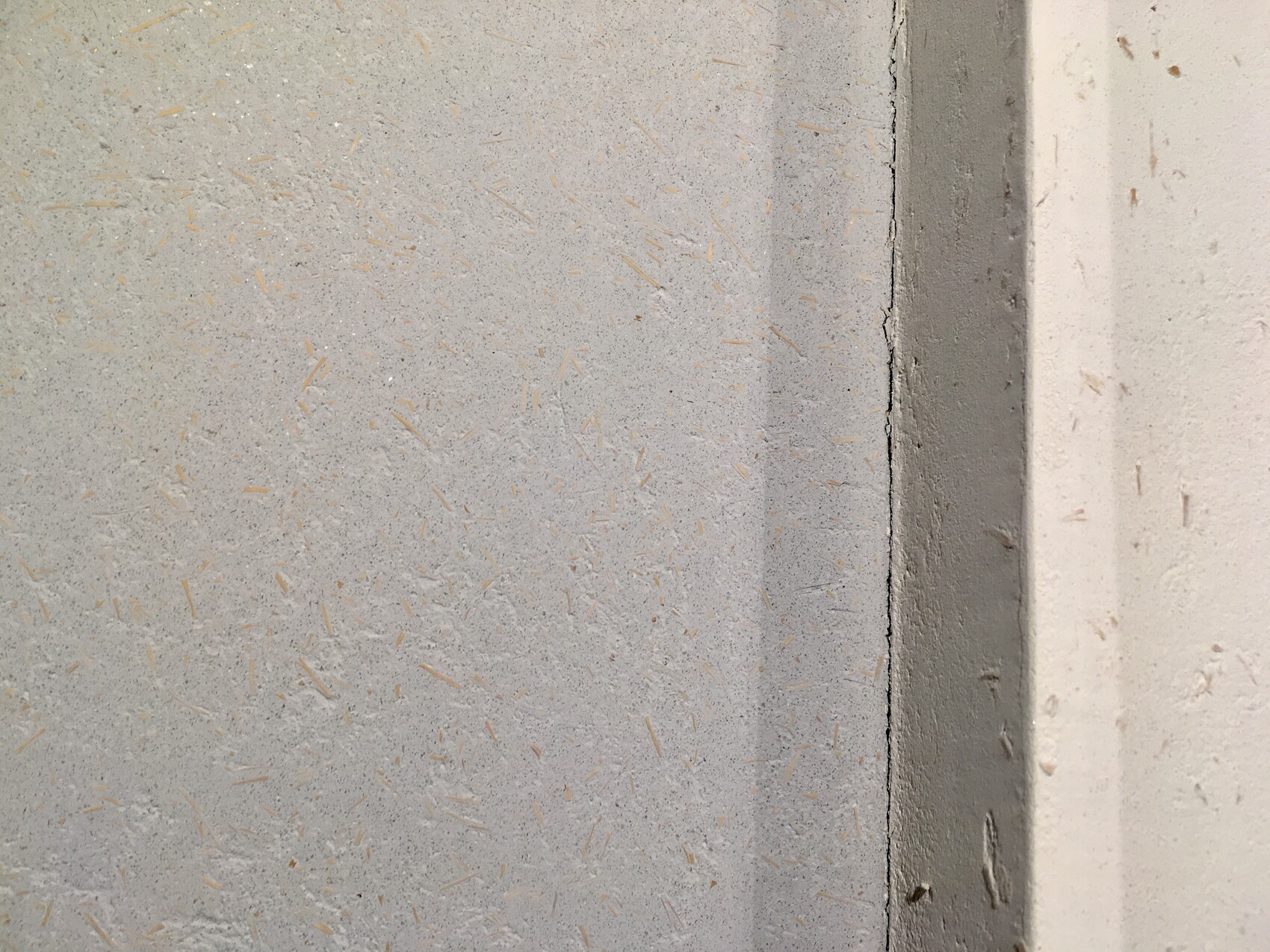

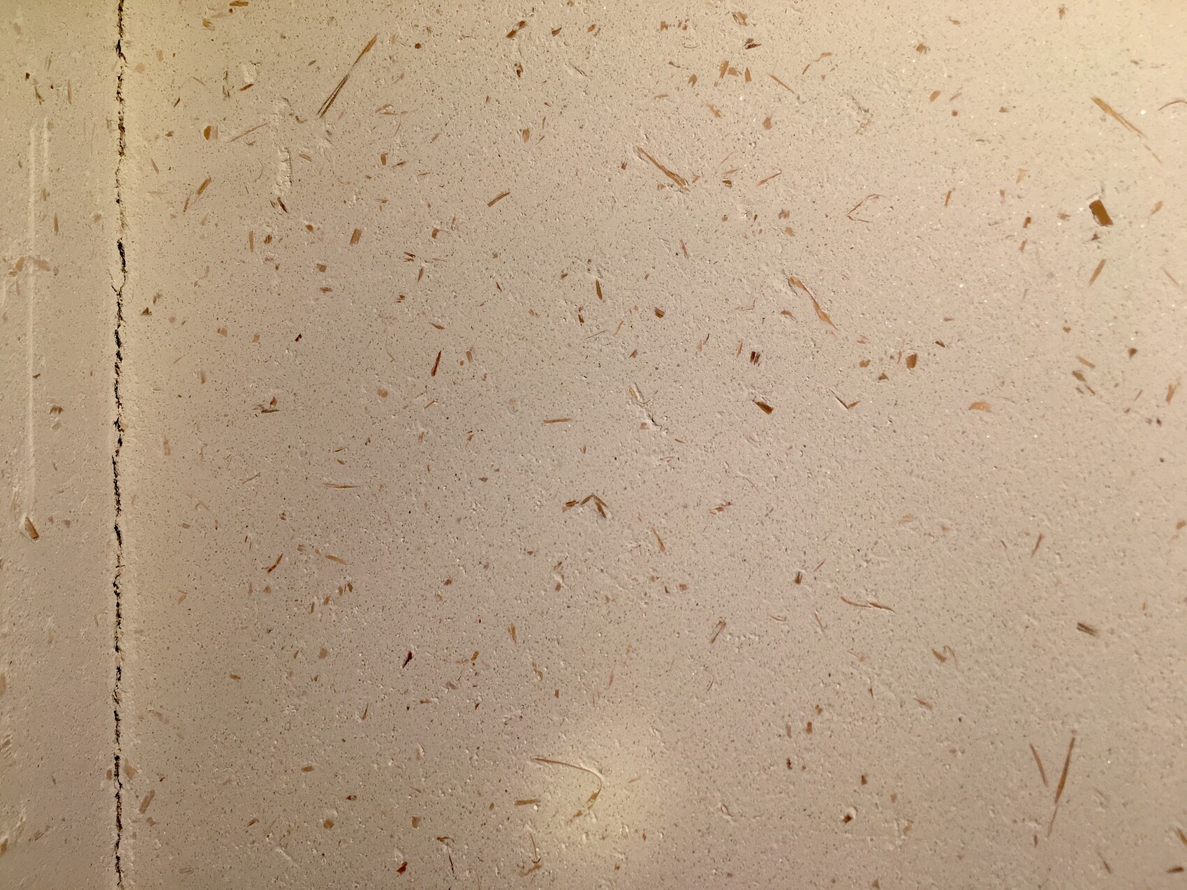

hampshire21 Mar 2020 19:25We chose clay plaster. Our painter/plasterer uses the Lesando system. The clay is pigmented throughout and is not painted. You can add texture elements into the plaster – we mixed in some straw. If you look closely, you can see it; otherwise, it just looks like a warm, lively wall.
The note about settlement cracks is correct – the painter/plasterer is aware of this. We have a timber frame house built by a carpenter. The wood naturally still moves a bit, and cracks appear at the corners of the rooms. That’s why the painter/plasterer has already scored a crack at those spots with a utility knife – it will expand somewhat. He will come back in a few months to repair those areas. So everything is planned for.
In the two close-up photos from our house, the colors do not appear as they are due to the mobile phone camera and artificial lighting, and shadows are also disruptive – but the texture and the crack at the room corners are probably still visible.
