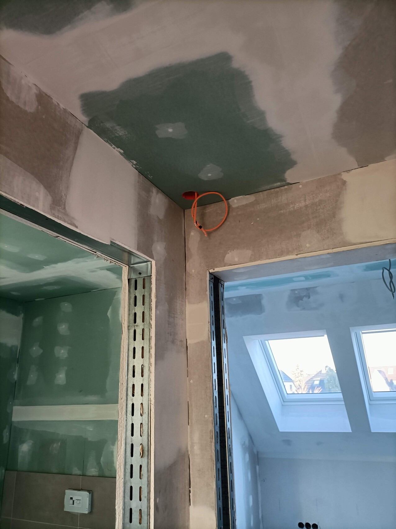

Wasistdennhier6 Jan 2022 16:48A bit off-topic, but maybe someone can help me.
We originally wanted to install the connection for the NanoHD in the center of the upper floor hallway ceiling.
Apparently, the electrician misunderstood and installed it as shown below:
This is obviously not ideal, since it’s not centrally located but in the corner, directly next to drywall only.
Will the performance of a NanoHD be significantly reduced compared to a central installation?
