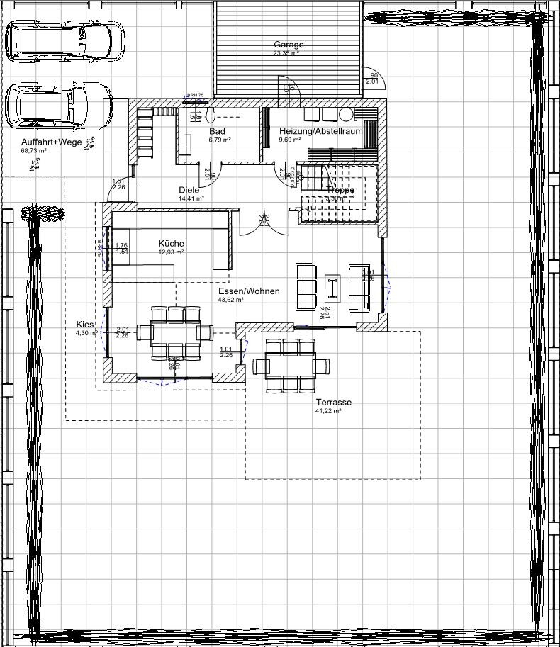

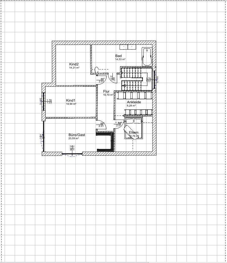

Thank you very much for your many ideas. Thanks to you, we were able to better organize everything and have now created a rough floor plan for ourselves... We would like to show this to the architect soon. Maybe you still have some ideas, criticism, or suggestions.
The entire design should be accessible, with the option to install a small elevator later if needed (top left in the hallway). Since we are not building a basement, we need substitute rooms for basement functions.
The heating room and the office/guest room, which is on the upper floor, will serve this purpose. We will not be using the garage for a car. It will also be used for storage.
As mentioned, this is just our current idea, and we welcome any kind of feedback.

The doors must open inward, and some of the windows are still missing.

Yes, that's correct. For now, I'm focusing on the rough floor plan. You probably still have some feedback, so I will add windows and doors to the floor plan afterwards.

For me, the bathroom on the ground floor is too large, and I would personally miss a children’s bathroom on the upper floor, which is very important to me. The distance from the dressing room to the bathroom is definitely too far for me, so for that reason (and because I find the door next to the bed too narrow) I would plan the access to the bedroom from the dressing room.

From my point of view, the house should be positioned as far east and north as possible to establish the best starting conditions. The seating area should be on the south side (ensuring evening sun), so the latest design is clearly the best one so far. Based on my experience, having two seating areas (except in special cases) usually isn’t really practical, similar to balconies on the upper floor if there is a terrace on the ground floor. One well-placed seating area—here: south side—is sufficient.
Regarding the rooms: I also find the bathroom on the ground floor too large, and having a “children’s bathroom” on the upper floor would definitely be sensible. As for the guest/office room: does it need to be that big? I would also miss a pantry: I would place it between the kitchen and living room, and in return give up the kitchen’s cross section and the double doors to the living room. With this change, you could reduce a portion of the (expensive) kitchen furniture and gain a great (small!) storage room. The wide corridor between the living room/entrance/dining area is visually appealing but offers little practical use.
I wish you the best of luck—you will undoubtedly manage to design the house according to your needs!
