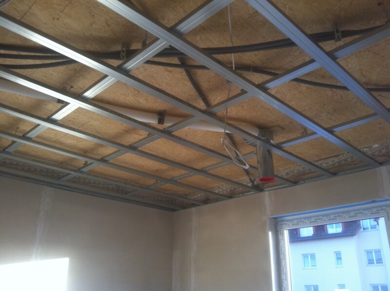

can someone briefly explain where the ducts for a mechanical ventilation system with heat recovery can be installed on the upper floor if the house has two full stories, the top ceiling is a beam ceiling, and the roof above is either uninsulated or has only 60mm (2.4 inches) of insulation above the roof deck? If the ducts are installed above the beam ceiling, they are outside the thermal envelope; if installed within the insulation, much of the insulation’s effectiveness is lost. Also, running ducts perpendicular to the beams is difficult. How is this usually done? Thank you.
