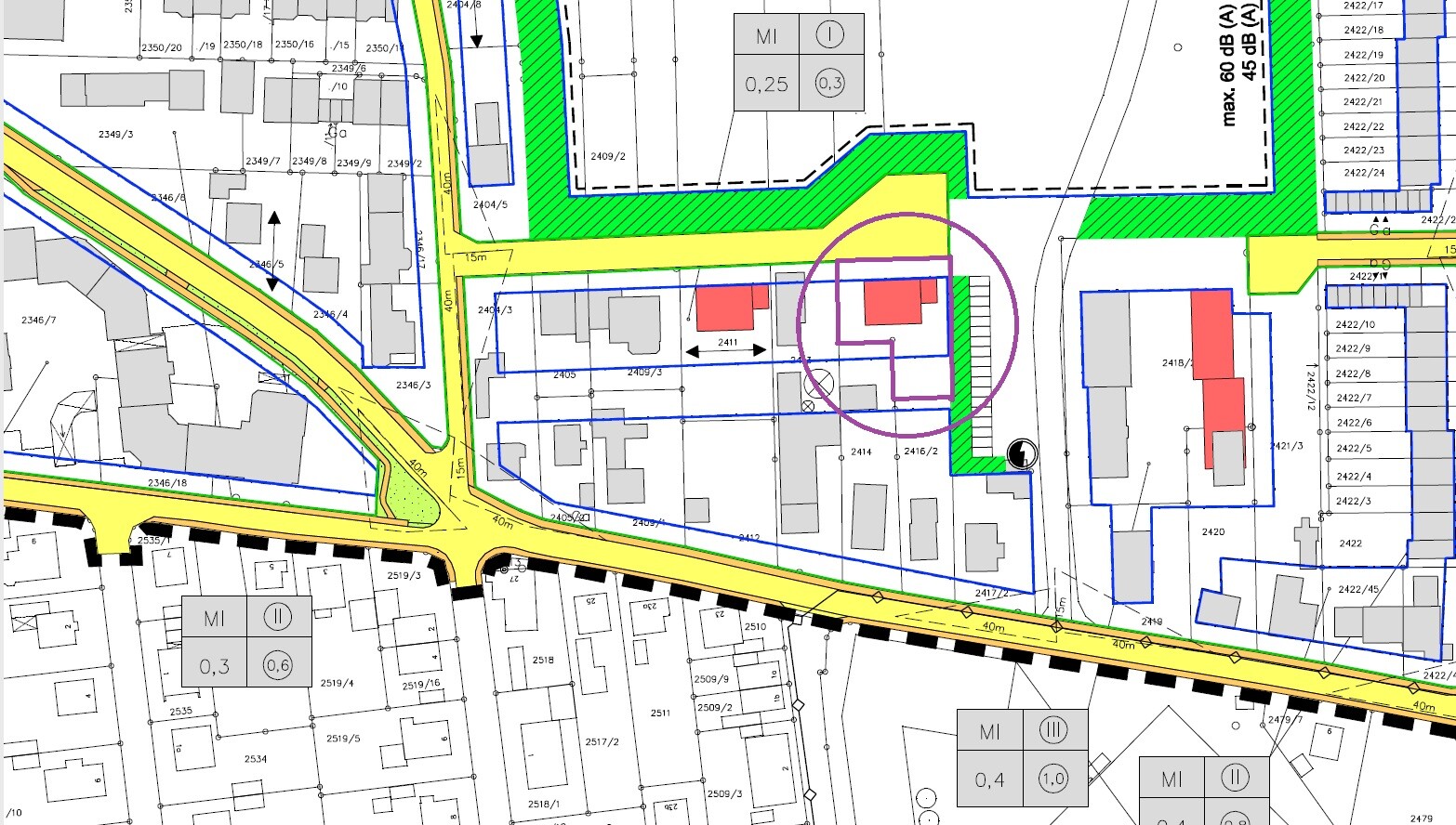

The plot in question is the one highlighted and circled in purple.
The yellow road to the north of it does not exist yet but is planned for 2020, as mentioned. The red house within the purple circle does not exist yet either; it was only marked in the zoning plan.
