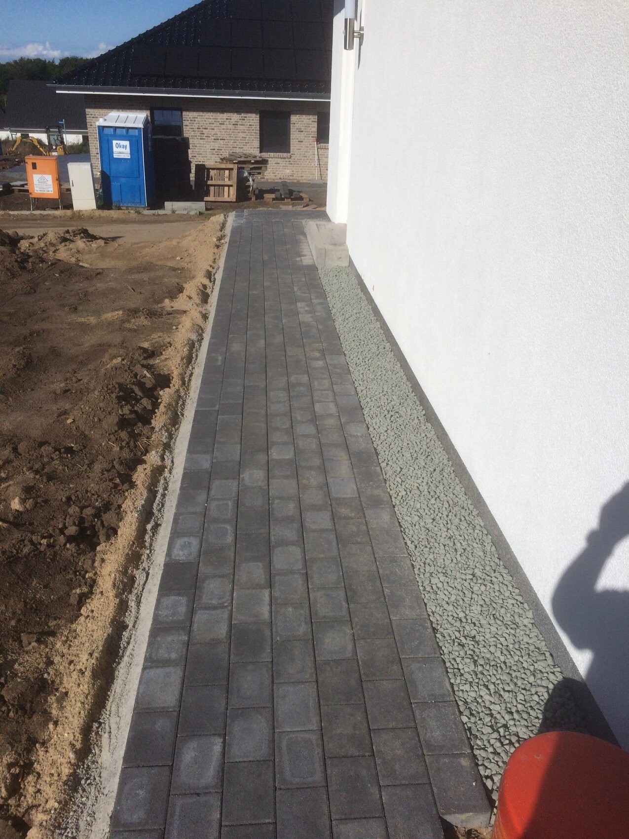

Why wait? Order it now and immediately! There’s no reason to wait. Once the roofer is finished, the gutters installed, the connections laid, and the plastering done—then the exterior is complete, and the landscaping contractor can work without disturbing the builders. For the driveway, use crushed granite gravel; it compacts well.
Gepflasterter Gehweg aus grauen Steinen neben weißer Hauswand; Baugeräte im Hintergrund.

It used to be said that you should wait about a year around the house because the ground settles. I’m not sure how relevant that still is today, or if it specifically affects the splash protection, or whether you should or can install it immediately.
How wide is the path in the picture above? It looks a bit narrow if two people are walking towards each other, right? Especially if one is carrying something, for example...

Tip: Rectangular gray paving stones 20cm x 10cm x 6cm (8 inches x 4 inches x 2.4 inches). Result: 70cm (28 inches)
