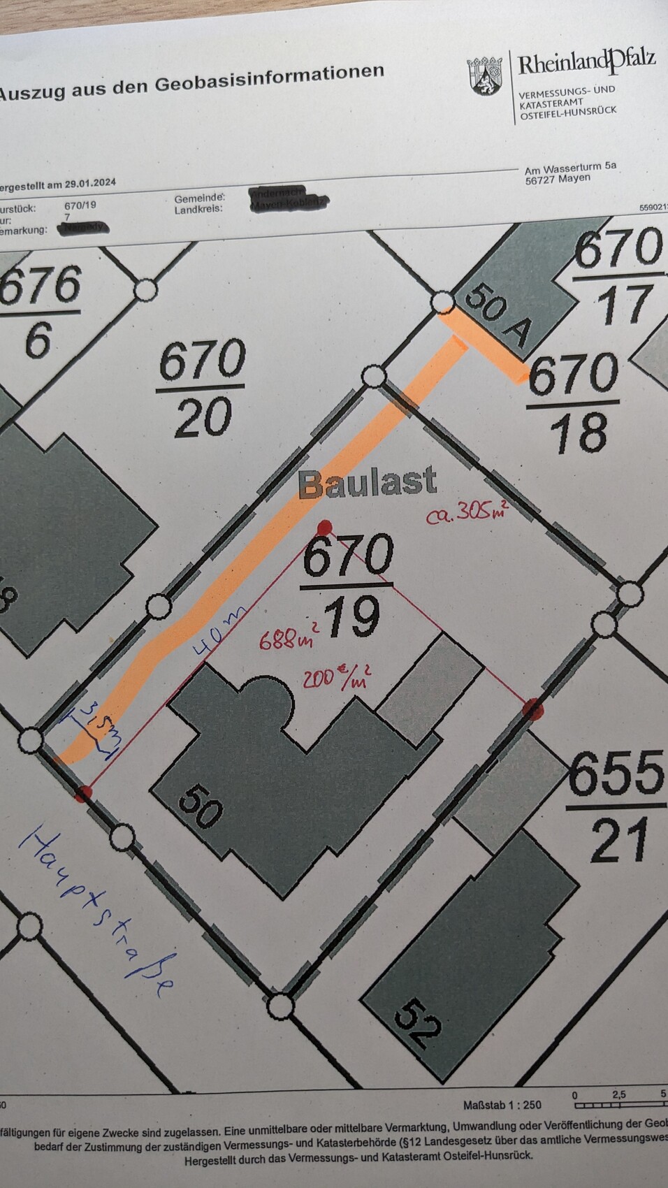

Buchsbaum066
6 Jun 2024 21:56
Please upload a site plan of the property with the house. That way, it will be easier to provide more detailed advice.
cp03525
14 Jun 2024 15:42
House 50 A with thin walls, flat roof, ground floor and first floor each 40 sqm (430 sq ft), detached, no basement, only strip foundation, is to be demolished and transported and disposed of via a paved driveway over 40 m (130 ft) long and 3.5 m (11.5 ft) wide.
Kartenplan eines Grundstücks mit Baulast, Parzellen 670/19, 670/20, Gebäudestruktur.
Buchsbaum066
15 Jun 2024 14:21
A demolition would certainly make sense. However, the building is located exactly on the boundary. Demolishing it would mean losing this development status. It would need to be clarified whether it might be possible to retain the old house and integrate it into a new construction in order to keep the status.
