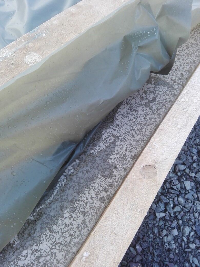

Stockheim20 Apr 2017 08:32Ok, then I’m relieved! I looked under the vapor barrier this morning and took a photo. These white spots are probably caused by the hardening process, right?

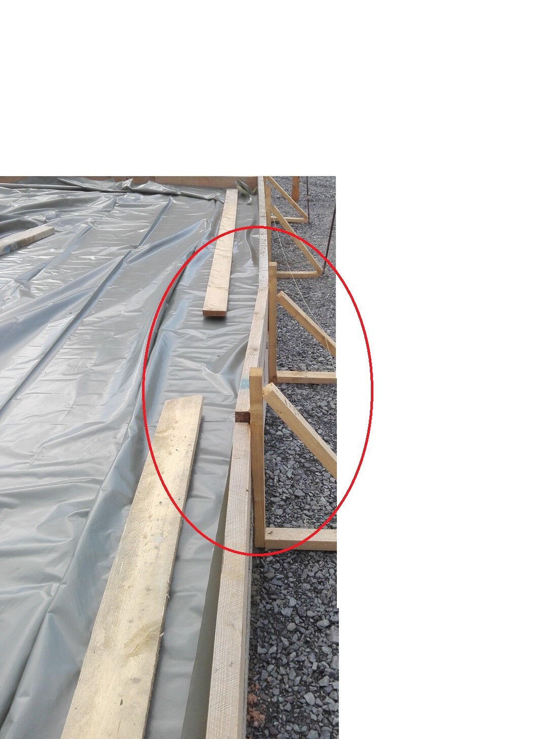

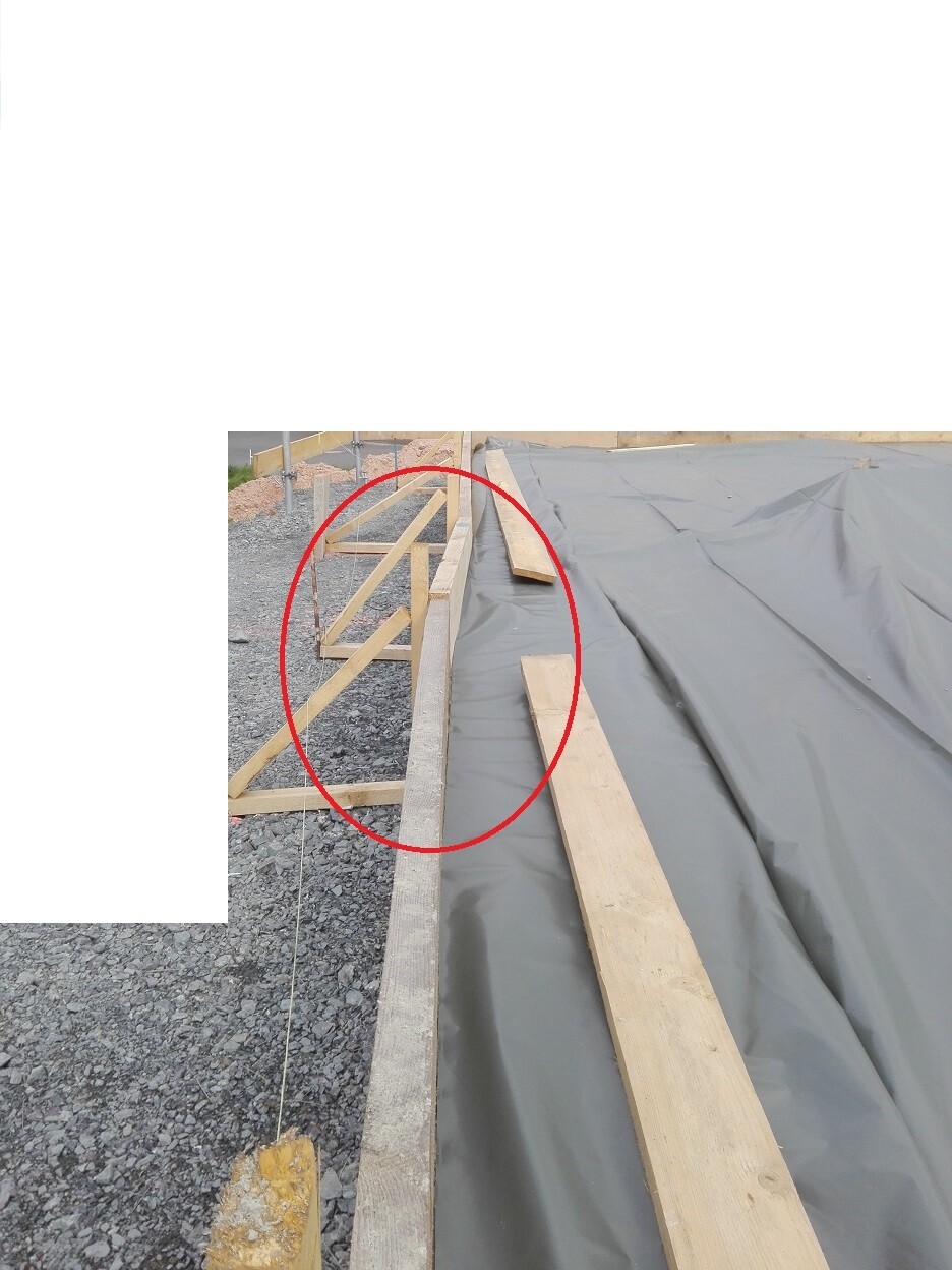

Is there any standard that specifies the allowable tolerance for a concrete slab? I was at the construction site yesterday and noticed that the formwork didn’t hold properly in one area. The slab is not completely straight there but has a slight bulge. Attached are 2 photos showing this.
