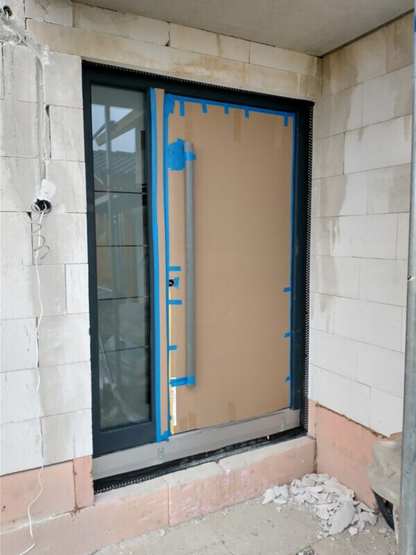

WilderSueden27 Jan 2023 13:06In our case, the door was installed after the screed; before that, a temporary construction door was in place. The screed installer insulated right up to the door edge and then used a plastic profile to prevent the screed from running up to the door. Currently, the door is protected with cardboard and foam.

xMisterDx29 Jan 2023 10:01Of course, you can install the door after the screed is laid. However, the risk that something won’t fit properly should not be underestimated. There needs to be an edge insulation strip or a joint between the door and the screed. If the screed installers work a few millimeters (inches) too far, the door won’t fit anymore.
It doesn’t have to happen, but if it does, it’s extremely inconvenient.

Yes, that’s what the screed installer told me as well. We will order the door soon and install it before the construction work begins, then protect it well with plastic sheeting, cardboard, and so on.
WilderSueden29 Jan 2023 10:09There is also the option to leave a hand-width gap between the door and the heated screed, which can then be filled with a bag of quick-setting screed after the door is installed.
