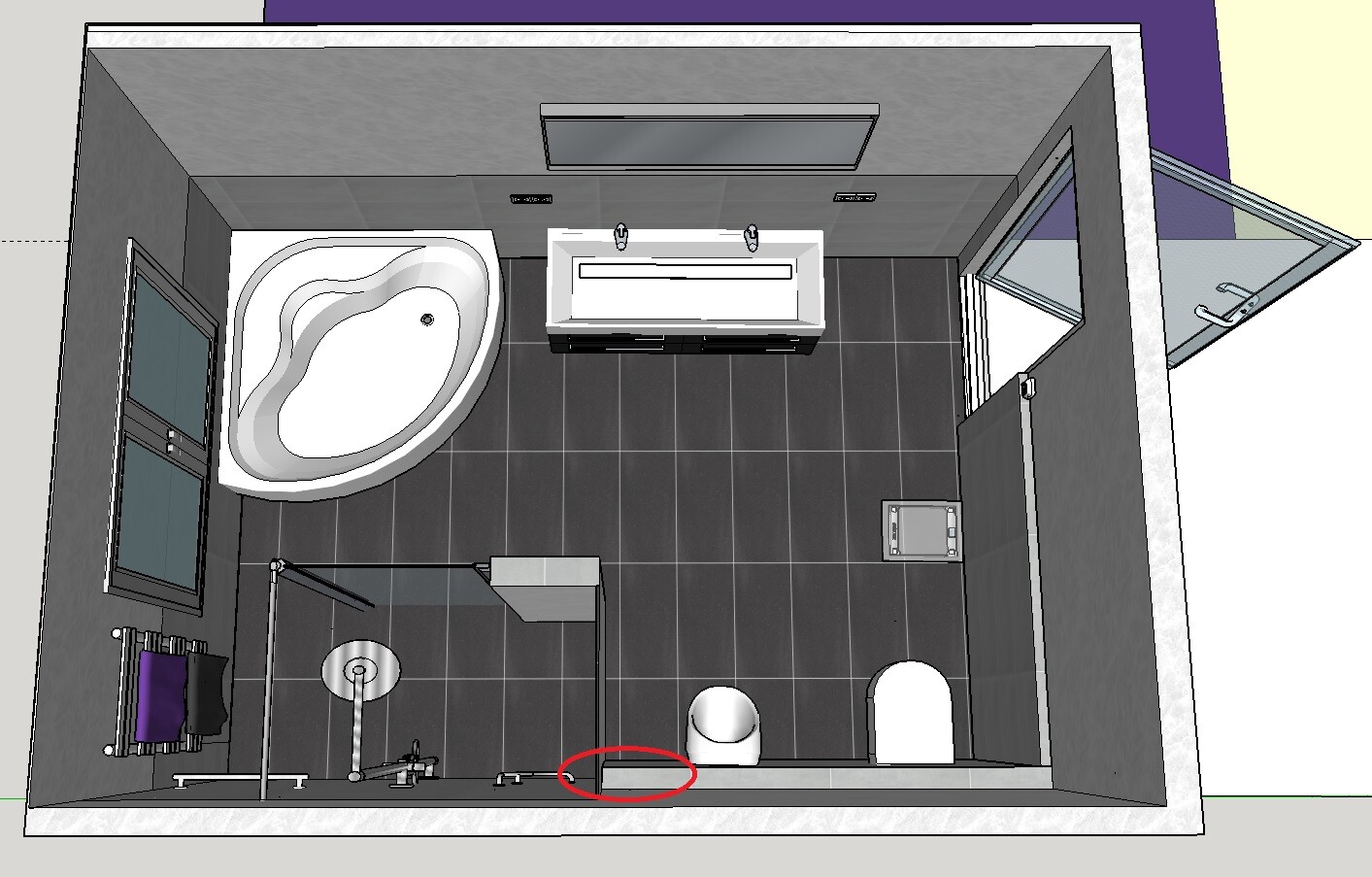

we are currently remodeling our attic and have the following plan:
We would like to convert our kitchen into a bathroom.
That alone might not be such a challenge...
But we have only one water supply and only one drain—both at about 30cm (12 inches) height.
We are considering enlarging the drain from 5cm to 10cm (2 to 4 inches).
Additionally, a substructure of 12.5cm (5 inches) height to lay the supply and drain pipes underneath. Has anyone tried this before? And how does this affect the height difference to the drain? Is this physically feasible?
I took the liberty to create a small 3D model and attached it to this post. The supply and drain are marked in the red circle.
Hoping I have explained myself clearly

Hausqualle22 Jul 2015 20:35Elina schrieb:
because for the toilet you need your 10cm (5 inches) diameter for the drain. .. that is not entirely correct ..Hausqualle schrieb:
.. that is not entirely correct ..That makes your post useless. So, how is it correct?
Hausqualle22 Jul 2015 21:22nathi schrieb:
So your post is useless. So how is it done correctly? ... well ... for a lifting station you only need 50 mm (2 inches) ...
