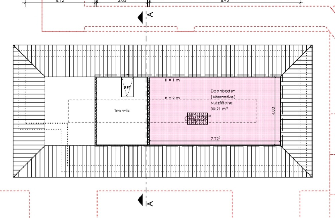

Where is the heating?
In the attic/loft! In the utility room
Attic floor plan: utility room on the left, loft on the right (usable area 39.9 m² (429 sq ft)), marked in pink
