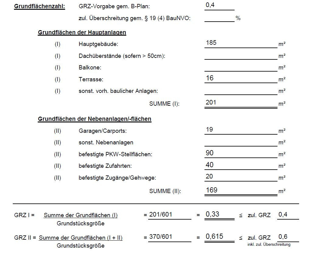

Well, something seems off in the calculation of the floor area ratio; I see it more like this:
Table for calculating the floor area ratio including main and secondary areas (m²).
The secondary floor area ratio numbers are estimated.

kbt09 schrieb:
Well, something is wrong with the floor area ratio calculation, I see it more like this:
I don’t quite agree!
The development plan dates back to before 1990.
Resolution to establish:
November 29, 1971
Legally binding since:
October 20, 1972
