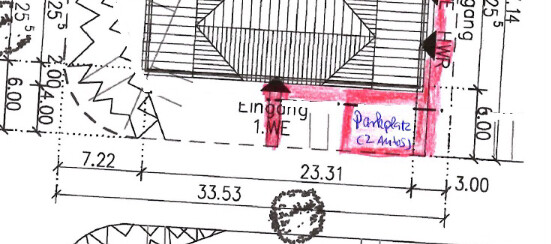

Hello, we are currently planning the outdoor area, and the paver is going to pave a parking space where two cars can comfortably stand side by side.
Unfortunately, we don’t have much space (the house takes up a lot of room), so I want to make the best of it...
Now my question:
How wide does the parking space need to be so that two cars can stand comfortably next to each other?
Next to it, I also want to have a path about 1.2 m (4 feet) wide to be able to walk to the house.
The property boundary is 3 meters (10 feet) from the house (on the right side).
P.S.
Maybe someone has a good idea how to nicely fit two cars?
They should be on the right side somewhere.
There is no garage or carport.
They should just be simple parking spaces.
Thanks to everyone.
Technical drawing of a property with buildings and a parking area marked in pink.

Besides, I also wanted to have a path about 1.2 m (4 feet) wide to walk to the house.
I would pave continuously without edges or steps, using the same material throughout. Because: the larger, the better. What applies to flooring also applies outdoors—minimize breaks and create a uniform surface.

We have 6m (20 feet) in width where a carport will be built later; the left side is against the house wall. This space is quite comfortable for parking a small 3-door car and a 3-series touring. A large paper recycling bin can also fit easily if both cars are parked properly. Since that isn’t even the case for you, I would consider 6m (20 feet) as sufficient space for the parking area alone.

I have 10 m (33 feet), which makes getting in and out very comfortable, and the children can open the doors forcefully without causing any damage. 8 m (26 feet) is also very comfortable.

I am considering paving the gable side. That would be 7.8 m (26 feet) by 6 m (20 feet).
There should be space for 2 cars, including a path to the side entrance.

Just drive both cars to an empty parking lot and test how much width you actually need. Park side by side and then see how well the doors open. If necessary, also consider space for infant car seats…
