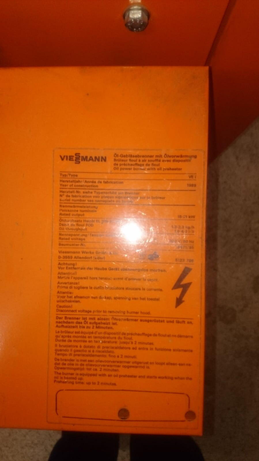

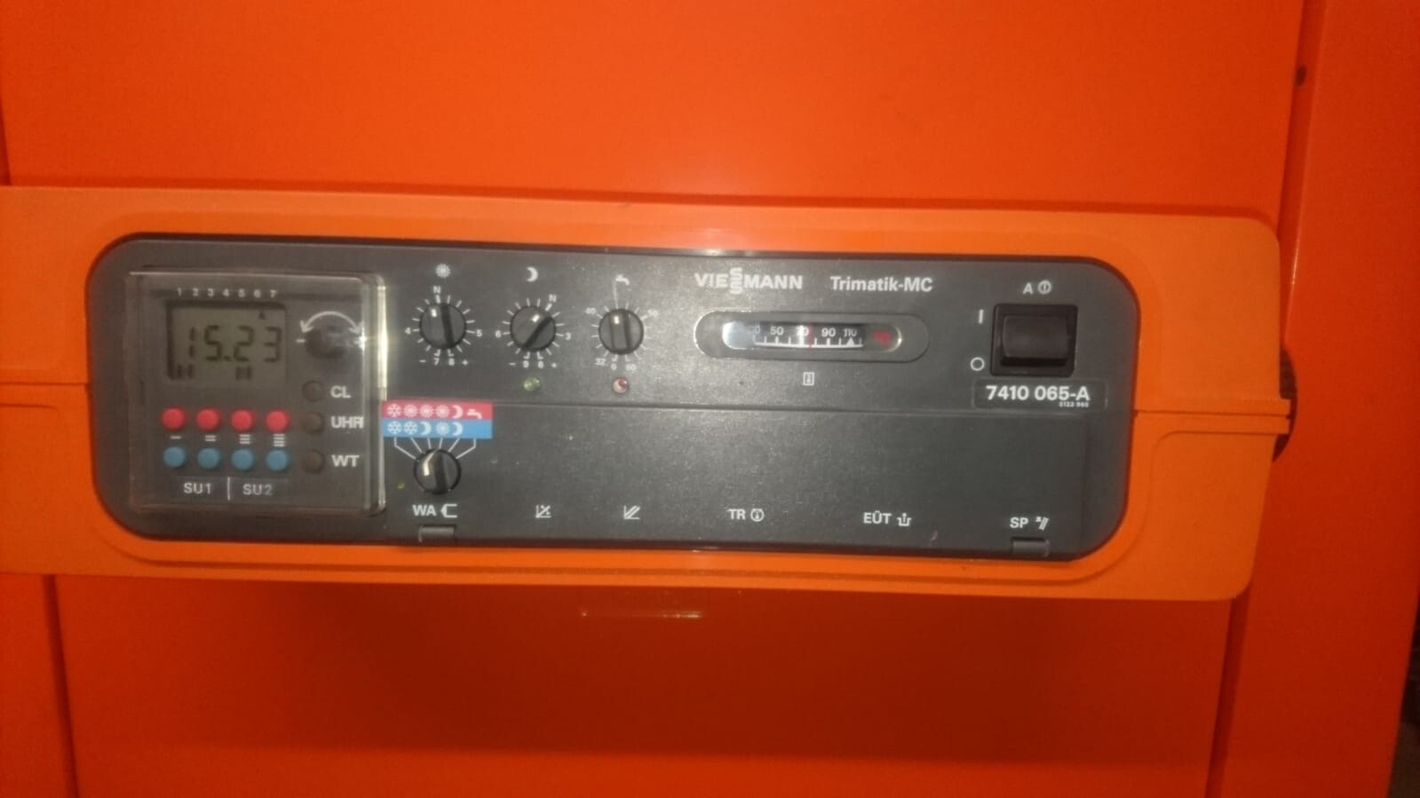

... 😱This is the current boiler; so far, no one has complained.
