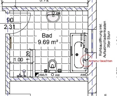

Here is the floor plan of the main bathroom.
2D bathroom floor plan with bathtub, sink, toilet, and door
Myrna_Loy
16 May 2021 18:41
It would fit space-wise. I just don’t like the layout. When you’re lying in the bathtub, your head is at the same height as the toilet, and when you’re sitting on the toilet, you see yourself in the bathroom sink mirror.
