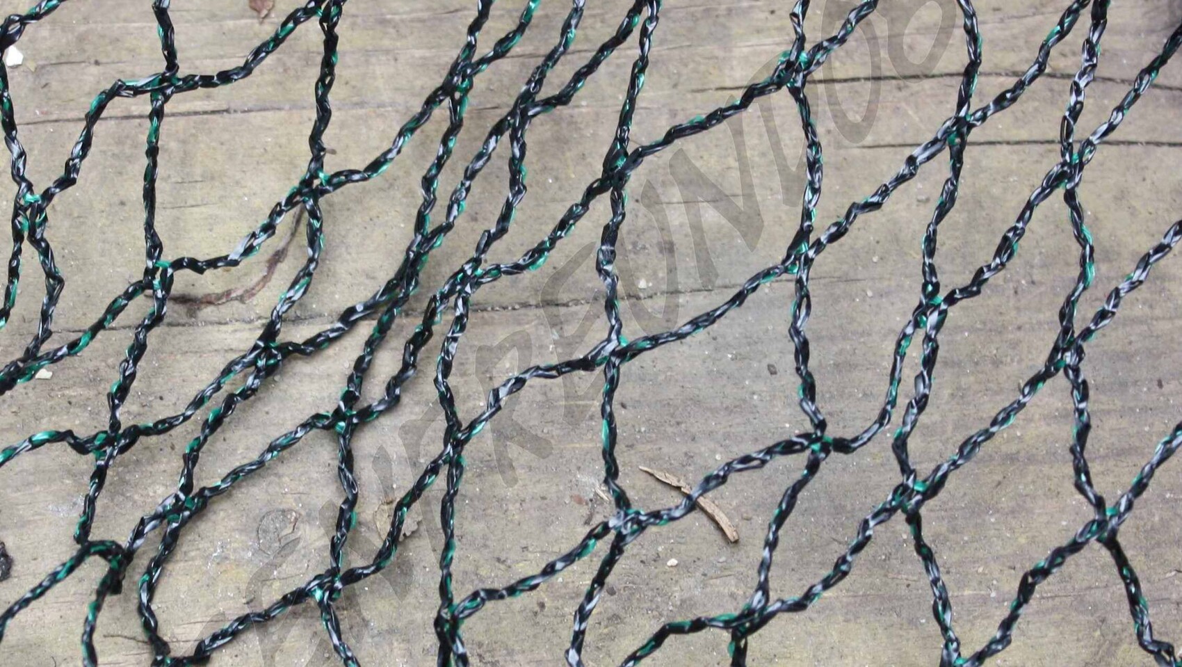

Gartenfreund22 Oct 2016 05:07I would recommend installing a net.
If you use the right net and stretch it tightly, no bird can get caught in it.
There are bird protection nets or pond nets available in different colors. However, avoid the cheap ones, which are usually light green, as birds can actually get trapped in those. Instead, opt for something like this (see picture). These are available at many hardware stores or garden centers. I just checked the website of a hardware chain, and these cost about €6 for 20 m² (215 sq ft).
Alternatively, you could also use rabbit wire.
