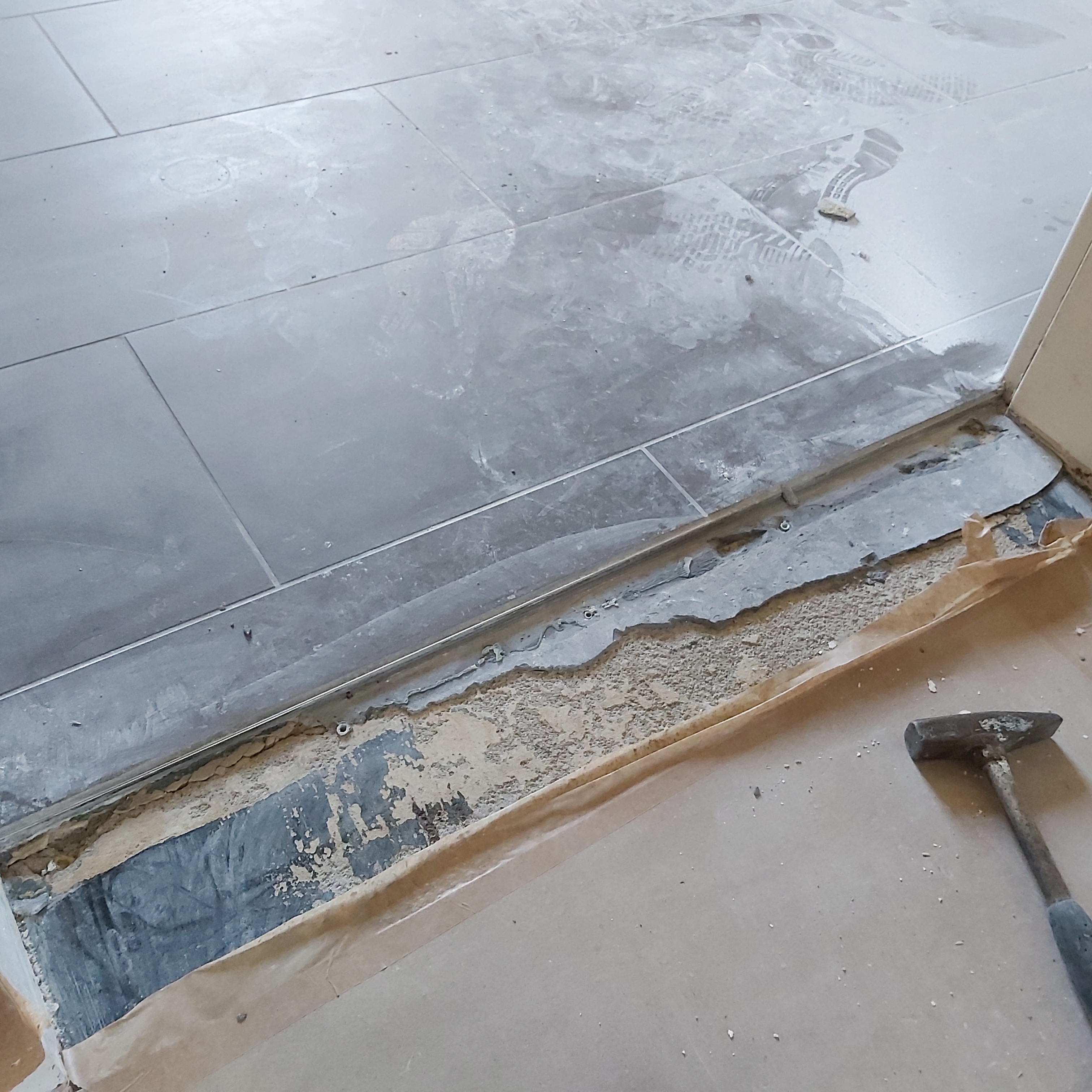

I removed my laminate flooring and now plan to glue down parquet. In the area around the door frame, there is still a layer on the screed that is already crumbling or easily breaking off in pieces. It can be easily removed with a chisel. What is this layer? Why was this material applied around the door area? Can this layer be removed, or does it possibly serve sound insulation purposes?

What you photographed between the door frames is joint compound that had run out from the surface of the adjacent room during the large-area surface filling process.
It can be removed, as it serves no purpose.
Ideally, this should have been done back then when the joint compound was applied.
