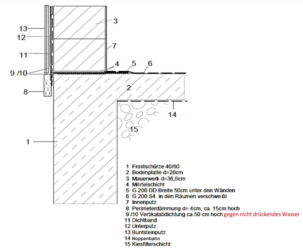

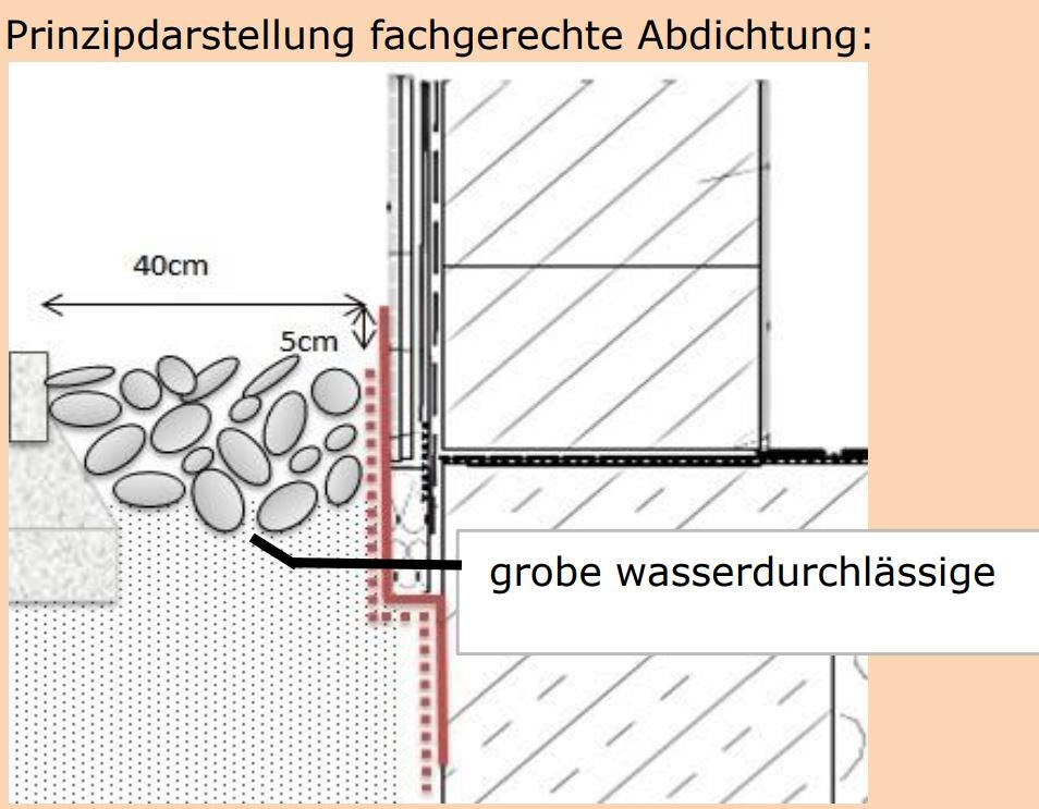

Bolle123Hello,
Our bungalow has the attached wall construction (Poroton brick). Now, in the new building specification from our construction company, I noticed an additional waterproofing layer with a thick coating and dimpled membrane. This was not included in our original specification. Currently, around our bungalow, we only have what is called a splash protection (gravel) without the thick coating. We have sandy soil. Is this additional protection still necessary, or is the waterproofing with the existing slurry under the perimeter insulation sufficient?
