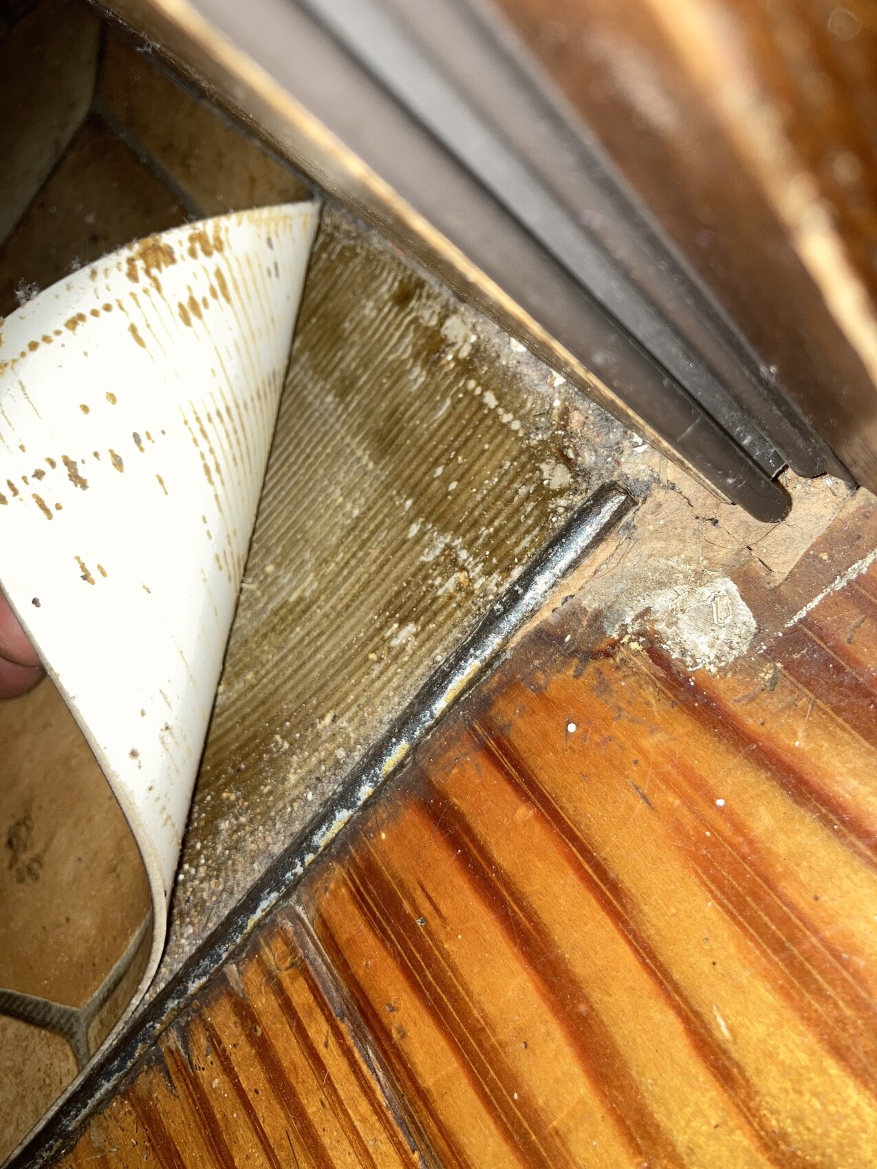

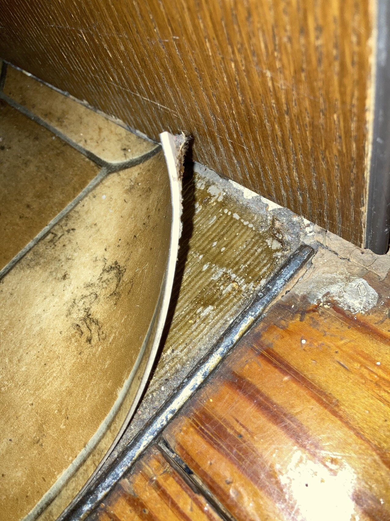

I have a floor covering here that was installed in a hallway on the ground floor. The flooring was laid in the 1980s. Unfortunately, I don’t have any further information.
This flooring has a tile look and is about 5mm (0.2 inches) thick. The floor is flexible and does not break when bent upwards. On the underside, there is no texture resembling paper or cardboard, and it is not gray.
Apart from the top layer with the tile pattern, the floor is almost entirely made of a white, flexible material. The floor is fully glued down with a yellowish adhesive.
In particular, I want to rule out the possibility that it contains asbestos. I understand that absolute certainty can only be provided by laboratory analysis, but maybe someone recognizes this type of flooring or can give a warning or reassurance based on their expertise.
I appreciate any information!

AdscheToennsen16 Oct 2023 14:3811ant schrieb:
I would classify the floor covering as linoleum and find it unfortunate that many newcomers simply ask their questions without doing some initial research. Otherwise, you would have noticed that when seeking expertise on flooring topics, it’s smart to tag @KlaRa in your thread.Thank you for your assessment. I will continue to investigate and try to find out if it really is linoleum.
Regarding your accusation: I, in turn, find it unfortunate to make assumptions without at least asking. I just checked: I have accessed the forum dozens of times since the end of August. Even in my specific case, I have read many threads on asbestos and flooring but unfortunately haven’t found an answer for my situation yet. If you want, I can send you a screenshot of my browser history for this.

First of all, thank you for the kind words!
Now, it is clearly and unmistakably an elastic floor covering, as it can bend back over the walking surface without breaking.
This effectively rules out any asbestos content. Asbestos was used many decades ago as an inexpensive filler in floor coverings; it had the additional benefit of improving fire resistance but was hard and brittle.
The backing also clearly shows that this is definitely not a linoleum floor. Linoleum either had a jute backing or a cork backing, neither of which is present here.
What remains, also considering the decorative pattern, is a PVC or polyolefin covering. Both are non-problematic materials.
At the time, it was poorly adhered with an obvious dispersion adhesive (also non-problematic).
If you consider the adhesive grooves compressed during the rolling process (which is technically necessary) and the unfortunately minimal adhesive residues on the backing, the most probable conclusion is that the elastic covering is a polyolefin material. After its market introduction, it was very difficult to secure this type of floor covering properly with the adhesive systems available back then...
So at this point: no cause for concern!
Best regards, KlaRa
Now, it is clearly and unmistakably an elastic floor covering because it can bend or fold back over the walking surface without breaking.
This practically rules out the presence of asbestos. Asbestos was used many decades ago as an inexpensive filler in floor covering production. It also had the fortunate side effect of improving fire resistance, but it was hard and brittle.
The backing also clearly shows that it is definitely not a linoleum covering. That would either have a jute backing or a cork backing—neither of which is present here.
What remains, also based on the decorative pattern, is a PVC or polyolefin covering. Both are uncritical types of flooring.
It was poorly adhered at the time with an obvious dispersion adhesive (also uncritical).
Considering the adhesive grooves that were crushed in during installation (which is technically necessary) and the unfortunately missing minimal adhesive residues on the backing, the most likely conclusion is that the elastic covering is a polyolefin floor covering. After its market introduction, it was only with great effort that it could be held on the floor as well as possible with the adhesives available at the time…
So, at this point: all clear!
Best regards, KlaRa Wow – thank you very much for this analysis! It all sounds very convincing. I already had a “gut feeling” which I tried to research in a layman’s way—but this is, of course, thoroughly well-founded!
