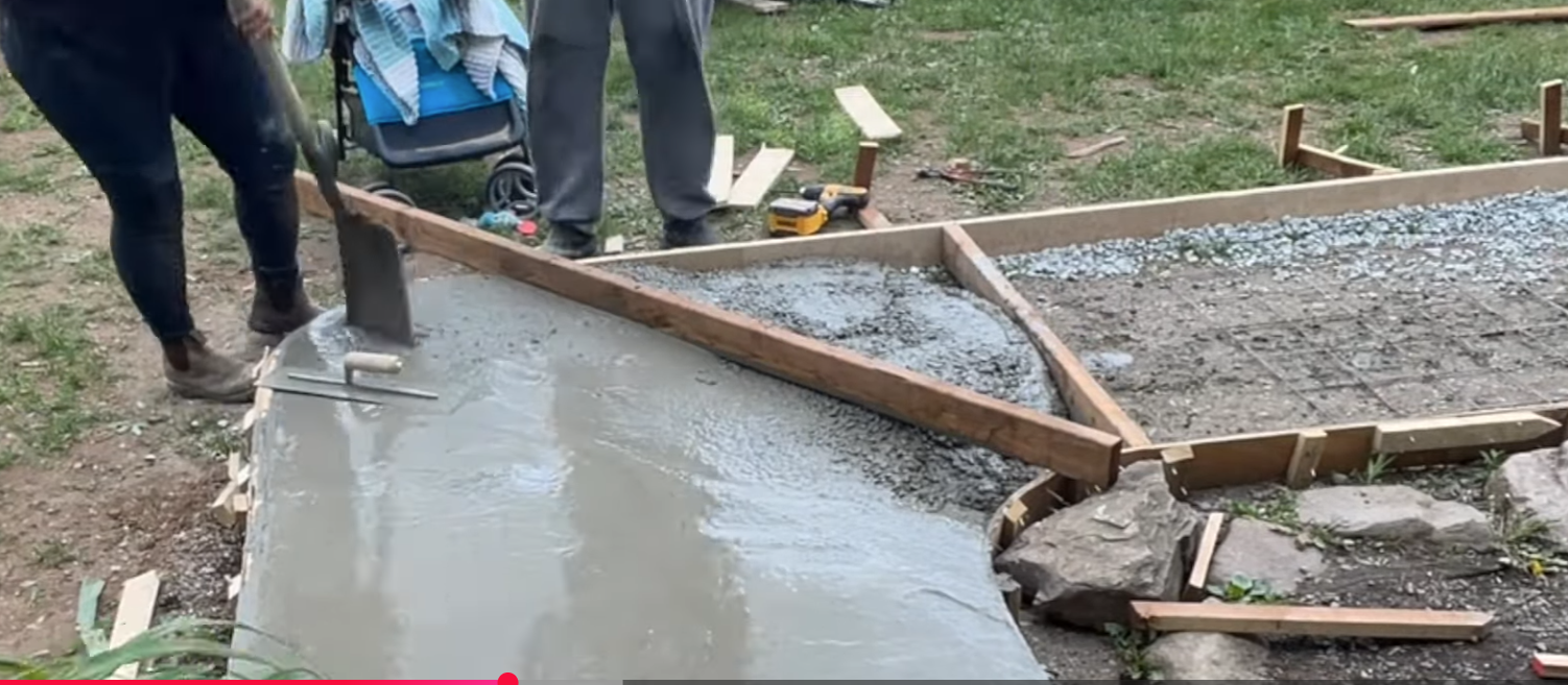

nordanney12 Mar 2026 09:03Grundaus schrieb:
I’m not sure what rammed concrete is supposed to be It looks like some kind of concrete or screed layer. So, simply 8cm (3 inches) of concrete on top.
