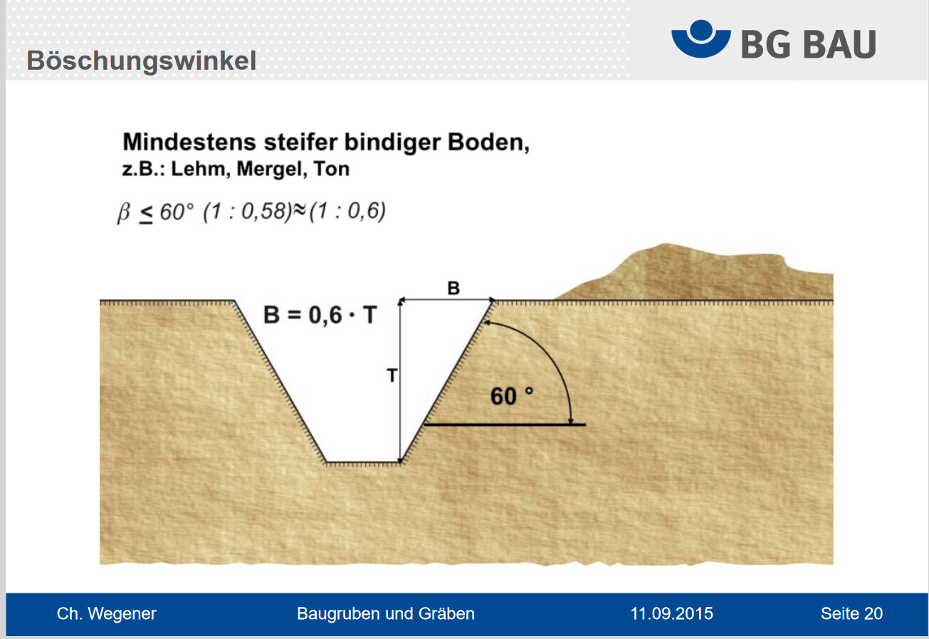

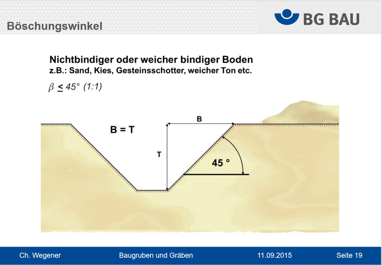

The most helpful resource I found was by searching for "slope angle" and "vdri," which leads to a PowerPoint PDF by "Ch. Wegener." Pages 19 and 20 (see screenshot) were very useful for calculating the excavation size. The calculation from the house wall would be: a working space of at least 60cm (24 inches) — shoulder width; preferably 1m (39 inches) or more — plus the width of the slope (labeled "B" in the images) plus 1m (39 inches) beyond the slope edge (for moving around and also as the minimum distance between vehicles and construction equipment from the slope edges, page 33 in the PDF).
