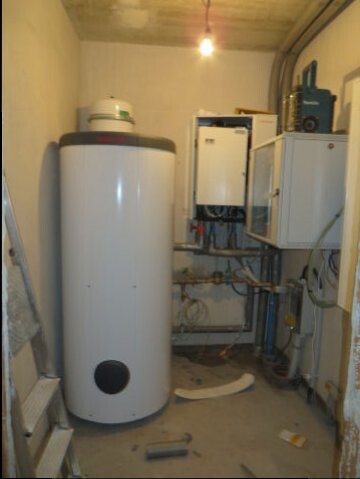

You have a separate utility room of a good 12 sqm (129 sq ft) available. But—if your layout hasn’t changed—the heat generator has already been moved into this room, because there was no space for it in the utility room. So, in that respect, your utility room could have been omitted.
By “housing unit,” do you mean the hot water tank or the heat pump? No, those were actually moved into the HVAC room, and my utility room doesn’t contain any building services equipment. The architect wasn’t sure if it would fit and cautiously planned it in the utility room instead. However, the plumbing and heating specialist said, “No problem, we can fit everything in there.”
I’ve added a photo. By now, it’s, of course, tiled, tidy, and we even have a small cabinet under the electrical panel. The electrical panel is at the far left edge of the photo, next to the network cabinet.
