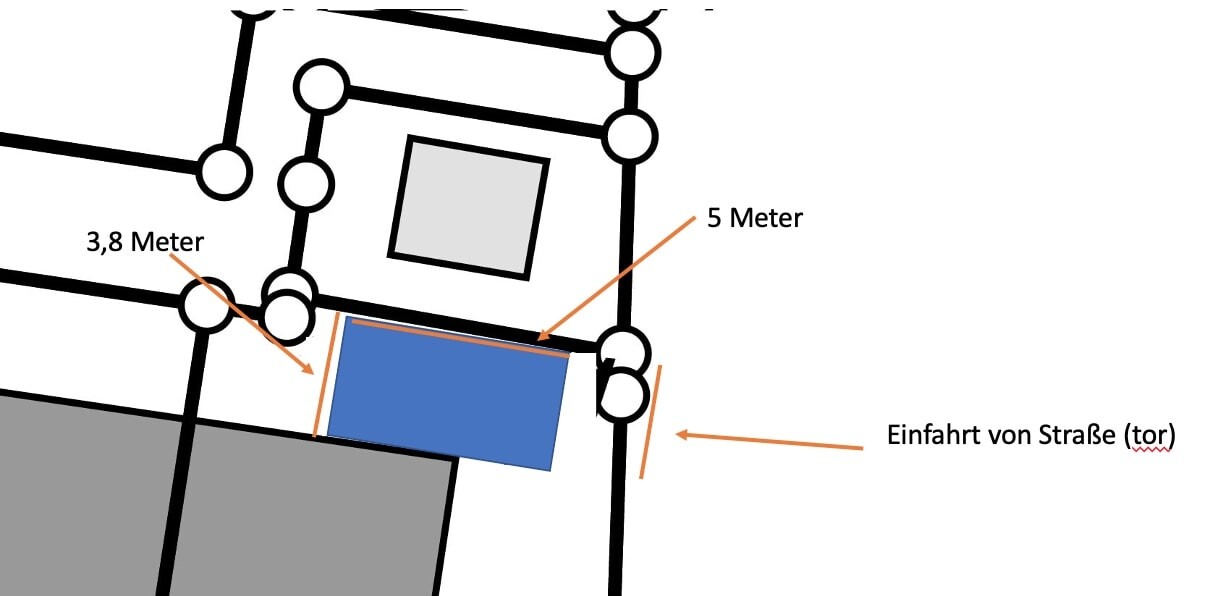

I want to build a carport on my terraced house. In principle, it shouldn’t be too difficult. Ideally, it should be partially attached to the house, but part of it will have to extend beyond the building line.
I’ve attached a sketch.
The project will be built in Bavaria. The person at the building authority told me that there is a development plan that applies, so I need to submit an "application for exemption from the provisions of the development plan." In principle, this is possible, but I have to ask the neighboring property owners for permission.
Now, the following questions:
- On the adjacent property above, there is a light gray square marked—it is a transformer tower owned by the energy company. Their boundary is right next to mine. Does anyone have experience with such cases? Would they typically refuse permission?
- Some carport suppliers have told me that carports up to 18 square meters (approximately 194 square feet) in Bavaria generally do not require approval. Is this true? I can’t find any information on this.
- I currently have two quotes, and they are very expensive. One includes a fence that I want between the transformer tower and my carport: 11,000 euros, the other does not: 8,000 euros. I find kits online with dimensions of 5m x 3m (16.5ft x 10ft) for 1,300 euros. What are your experiences or what would be a reasonable price here? The carport should have a glass roof, otherwise no special requirements.

I don’t really see any possibility of approval. Usually, carports are not allowed to be built so close to the driveway, at least here with a minimum distance of 5 meters (16 feet). And if someone at the building authority says there is a development plan (not a building plan) that doesn’t permit carports like this, why should you be granted an exception? That would be unusual since the idea behind the development plan is that everyone in the building area wants (and is allowed) the same standards.
hanghaus202325 Jan 2023 11:36romnBG56 schrieb:
The whole project is planned to be built in Bavaria. Here, the person at the building authority told me that a building plan applies, and therefore I have to submit an "application for exemption from the requirements of a development plan." Basically, this is possible, but I have to ask for permission from the neighboring properties. That is your first step.
Regarding the gate, I hardly see it being approved. Otherwise, move it back a bit so that you can maintain a 3 m (10 feet) setback.
